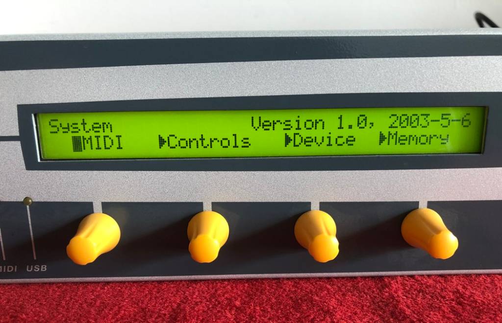

When I got my NOAH EX w/o keys because the owner didn´t find, the machine worked too and it looked like this,-
system software version is displayed ...
What does your´s read now ?

Here's a pic of showing the Noah firmware version
Cheers , Michael

MrV wrote: Sun Feb 04, 2024 6:01 am Here's a pic of showing the Noah firmware version
that´s the latest which I have too.
Noah´s USB-LED should be lit only when there´s the USB connection between host computer and Noah.
It doesn´t indicate MIDI ...
Might be dead,- or any other defect.
