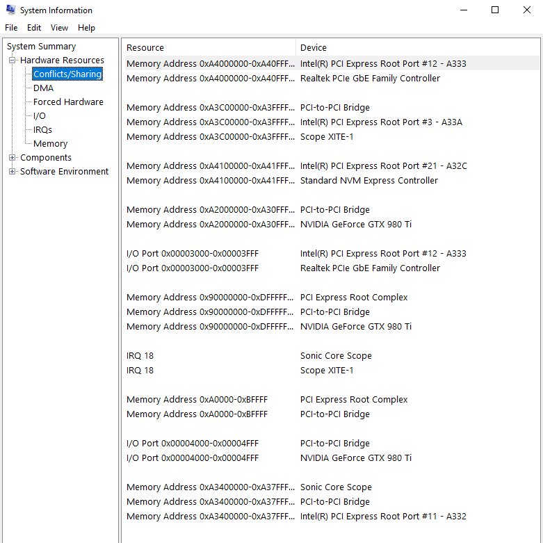

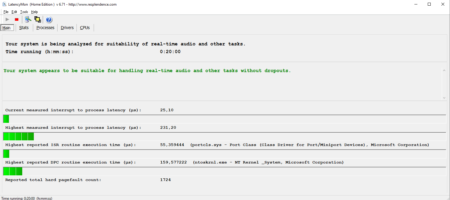

I have been finetuning both bios and windows for 3 days now but unfortunately I am simply not able to get this build click free either. The XITE is doing better (or the same as the old build) and I only get the occasional click, the 2 PCI SCOPE install is worse off:

I don't see anything sharing any longer, each device 'shares' with the port it's attached to and no more from what I see in the first screenshot, so no issue there.

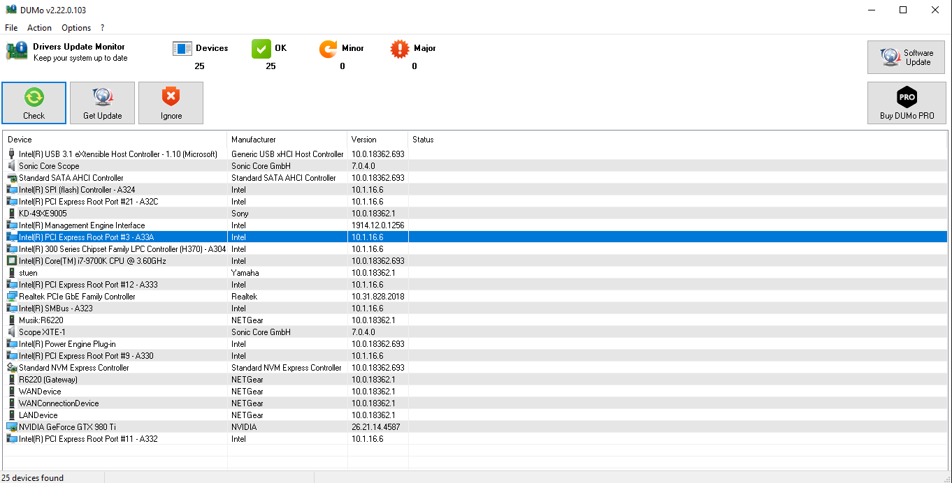

DUMo shows all drivers updated, so no issues there.
Is LatencyMon being run with nothing using the system or are you monitoring it under a workload of the kind that generates your clicks? In the timeslice shown there it's clearly not the cause of the clicks but...

Latency Monitor was running while I was running "my test" above.

Your LatencyMon readings are better than mine btw, I suspect there's hope.
