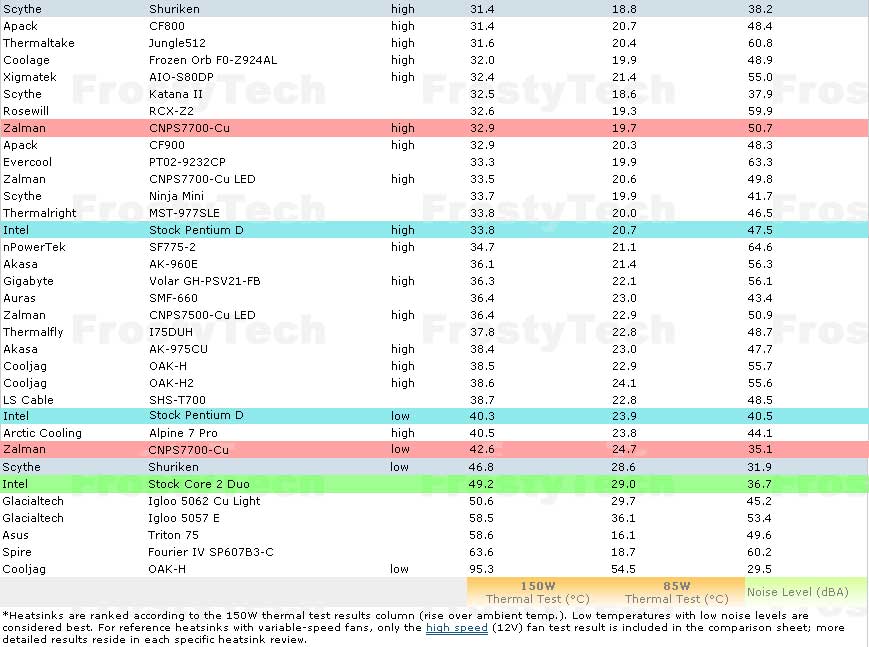

This table with data extracted from FrostyTech.com reports values for Scythe Shuriken, Zalman CNPS 7700 Cu, and Intel stock Pentium D and Core 2 Duo coolers.
In my system I have a rise of 22° - 23° C using the Zalman CNPS 7700 Cu with a Prescott 3Ghz (800 Mhz FSB) in idle state, and 44° - 45° C full load @ 20° C ambient temperature, but there's a 25 cm fan on the case side blowing toward the CPU cooler (at now it's manually speed regulated, but I'm experimenting with a circuit using a thermistor in these days)

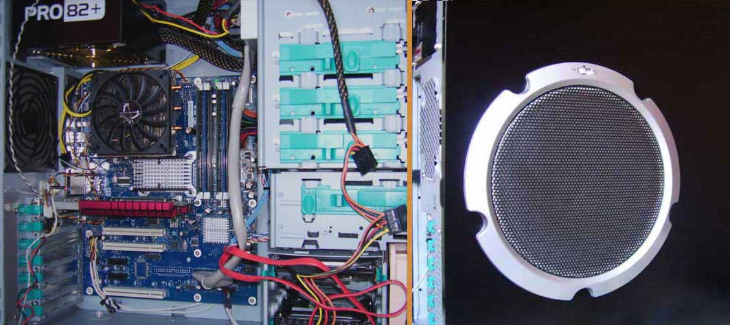

I've got the Scythe Shuriken here now, together with an Intel DP35DP motherboard, a Core 2 Duo E8200 and an Enermax Pro 82+ PSU.
The Shuriken 10 cm fan isn't audible till 1200 RPM even at 60 cm, running it alone; at faster speed, only air whoosh from it, no mechanical noise.
At the first startup I was in the BIOS for a look at temperatures and fans speed and I was dazed by the 62° C displayed in the CPU field. Something wrong with the thermal compound? Badly plugged clips?
Having a better look at the temperature fields I noticed that the one reporting 62° was labeled 'CPU thermal margin'....
The thing I had to work on was: the Shuriken fan, PWM controlled, driven by the DP35DP with the E8200 (updated BIOS) rotates around 380 RPM.
I was not able to find any BIOS setting in order to actually change this.
The whole BIOS itself is quite essential, indeed.
Surfing the documentation I found out that CPU fan speed increases only when VERY close to the thermal margin.
Running some load test I noticed that the temperature of the components beside the CPU (voltage regulators, S&N bridges) does rise faster than the processor, having the fan running at that slow speed....
(Of course I made a quick test with fan stopped, having very similar results).
These temperatures were quite high even working with not too heavy load.
To cut a long story short I had to build some regulators.

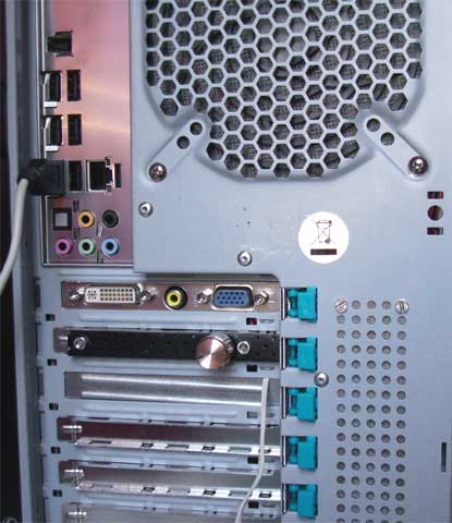

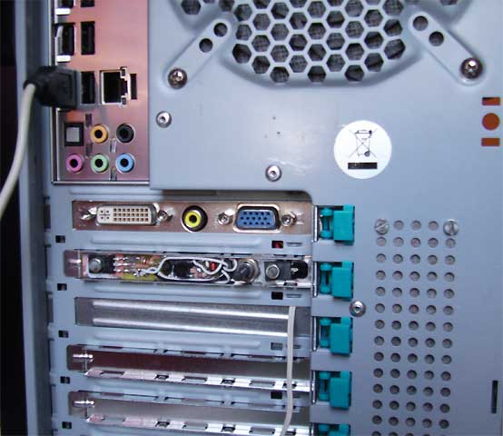

I used a MJE350 PNP transistor, a 22KOhm potentiometer( not easy to find a miniaturized one here), 1200 Ohm resistor and a capacitor.
Of course I didn't use the PWM wire.
I even built a regulator for the 25 cm case fan, using a NTC thermistor, a couple of transistors, resistors and capacitors, and mounted both them in a PCI slot cover ( the kind partially sticking out of the case, not the flat one...I'll post some pics...).
Now the Shuriken fan is adjusted around 760 RPM, it's unaudible, and the temperatures are low even running continued periods of heavy load.
The 25cm fan runs at minimum speeds till the temperature inside the case is below 30° C and rises close to the maximum speed at 38° C. :) ( I tested it outside; inside the case I never was over 27° till now, graphic card only)

ADDED PICS:
the 2 luna II will be placed soon
fans regulator without cover
the fans regulator
the fans regulator
