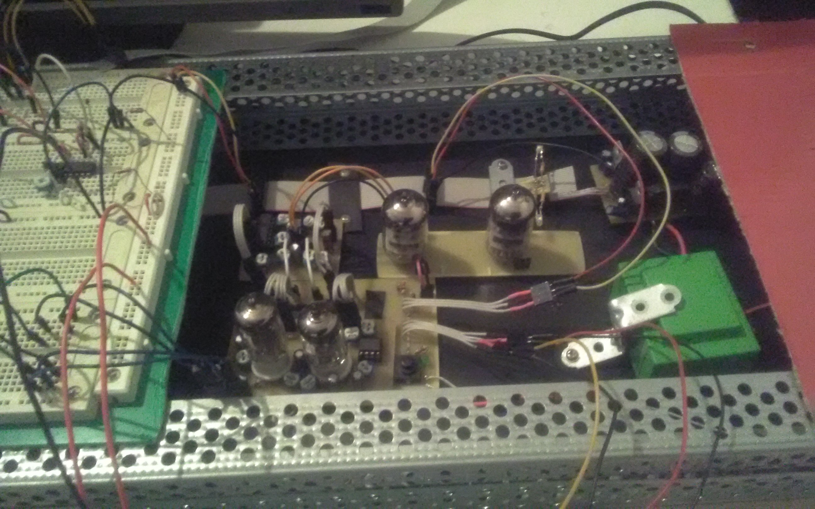

ps I didn't bougth the tubes, i have made it with my hands. it was the last circuits i designed before i decided that i am ok with analog for the time.
I dived around ten years in analog electronics, it helped me get a perspective.

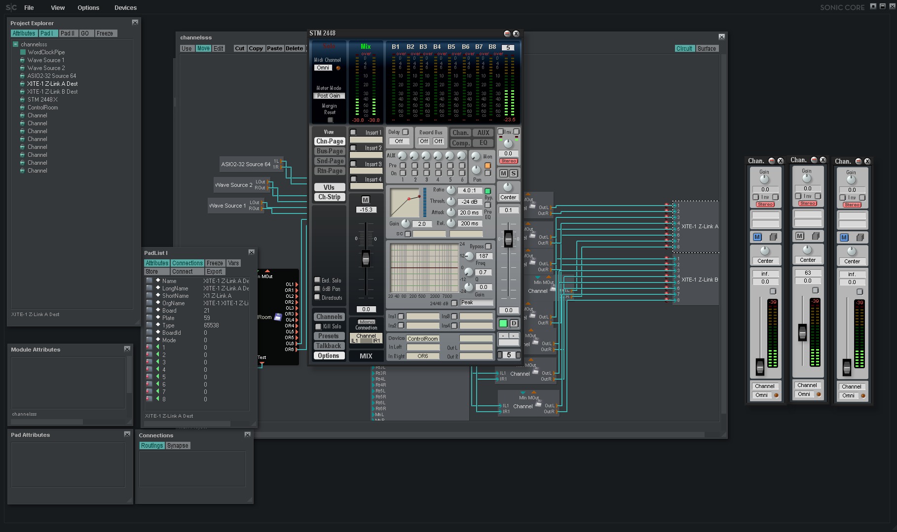

@yayajohn: My issue in not related to load. I can do wild dsp allocations without loosing sound within a project.
But on reload, the sound is gone and requires strange actions to get it back.
I just tried this in my project shown above:
Allocating the upper 4 channel elements and the upper Z-Dest to DSP8... everything works, sound is present.
Now I save and reload the project.. and there is no sound.
As the channel-elements show ampltiude, I tried all DSPs on the upper Z-Link Dest, but no way to get the sound back !
( The lower Z-Link Dest wasn't allocated to a certain DSP and works well.)
I also own the sdk, but I don't know where to look for DSP for an element.

So here comes the DSP-location measurement (thnX for you howto):
A) working project, no manual allocation:
channel = (0,9)
Z-link = (0,0)
B) same project, after manual allocation of one channel and upper Z-link dest to DSP 8
channel = (0,7)
z-link = (0,7)
Setting DSPId allowed me to change the channel to (0,9)-
The Z-link shows no change on DSPPlacement, no matter what DSPId I set.
(Some screens: clip4 and 3 show Z-link not reacting to assignment; clip2 shows channel with working assignment, clip1 shows an exception during folding, which might not be related to this discussion)

Re: no sound after dsp assignment ?
what happens if you put all three to dsp 7?
if the z-links are locked to 0 dsp then set 0 at the z-links dsp id and then use channel 10 for the channels
you can also try folding the three modules set their dsp id to -1 and then assign the dsp for the module
what happens it goes to 7 and stops accepting further changes? perhaps leave the z-links to dsp 0 and use dsp 10 for the channels
does this work after reloading the project?

within scope:
allocated channel, z-link to DSP7.
all working, but after save and reload just silence.
loaded in sdk:
the allocated channel and Z-link report (0,6)
the functional channel and z-link report (0,9) and (0,0)
Now I set DSPId 10 for the allocated channel and I get (0,10)
Then i set 0 to the z-link and it stays at (0,6) .. this doesn't change on any and DSPId I tried.
I tried to save the project from sdk to check for changes on reload, but it refused due to "illegal things" I made
loaded in sdk:
