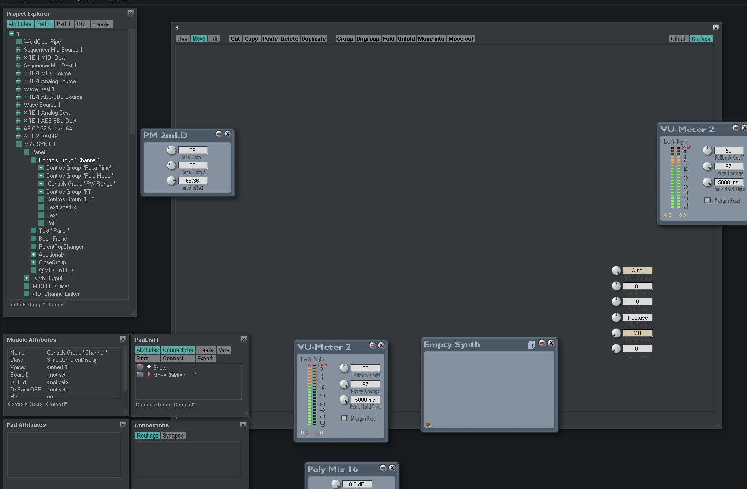

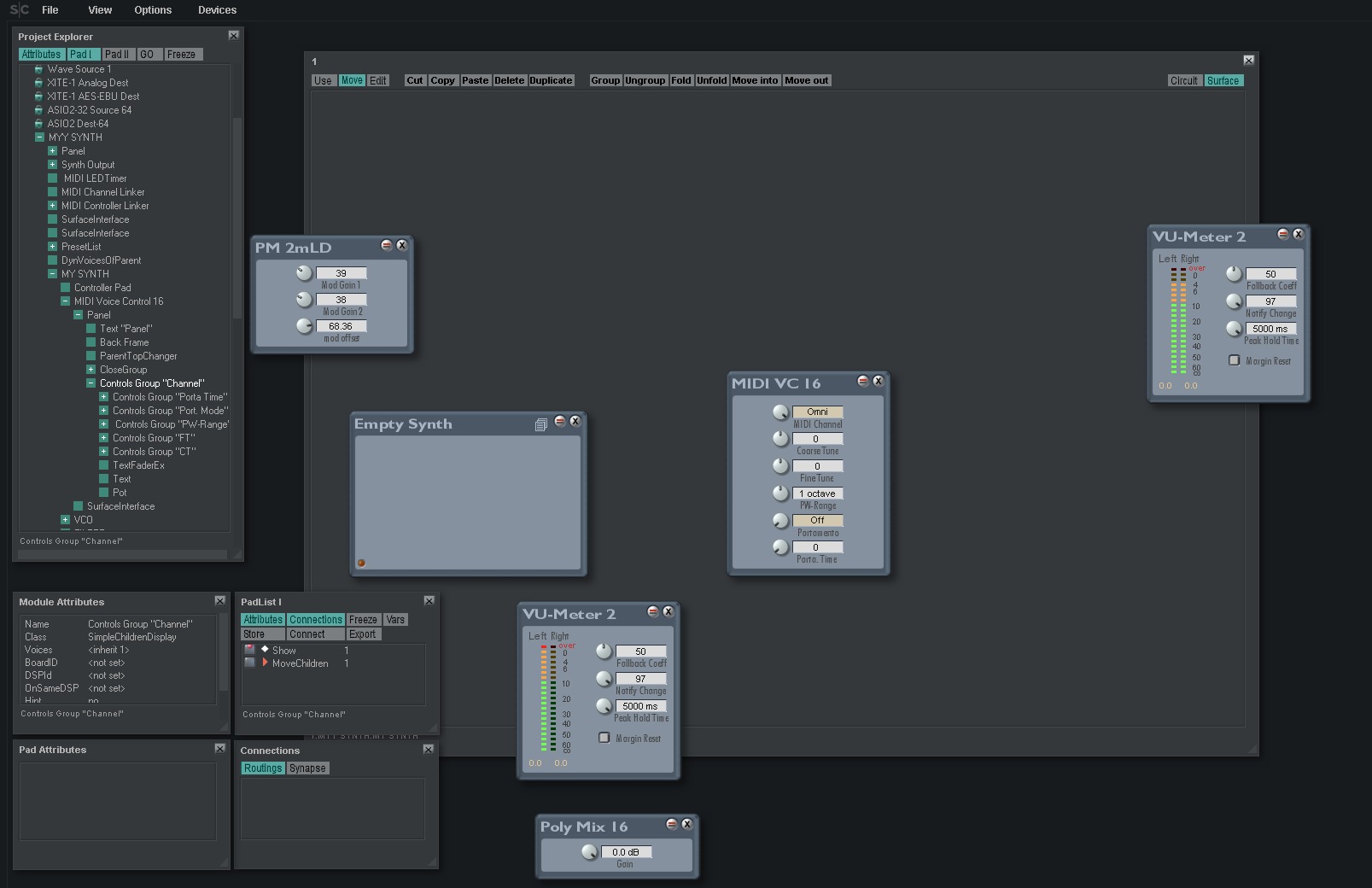

Re: TUTOR VIDEO - Make a synth in Scope SDK in less than an hour
Thank you for the detailed background information.
I'm still stuck at this "movement".
I can group the objects in explorer.
Clicking between poti and display selects the group in explorer, but I don't get that box in the graphics.
I cannot move the group.
So I tried to move the controls group in explorer into the empty synth.
I appears now right to the synth, but I cannot move it.
- Clipboard02.jpg (145.24 KiB) Viewed 50008 times
- Clipboard01.jpg (159.82 KiB) Viewed 50008 times

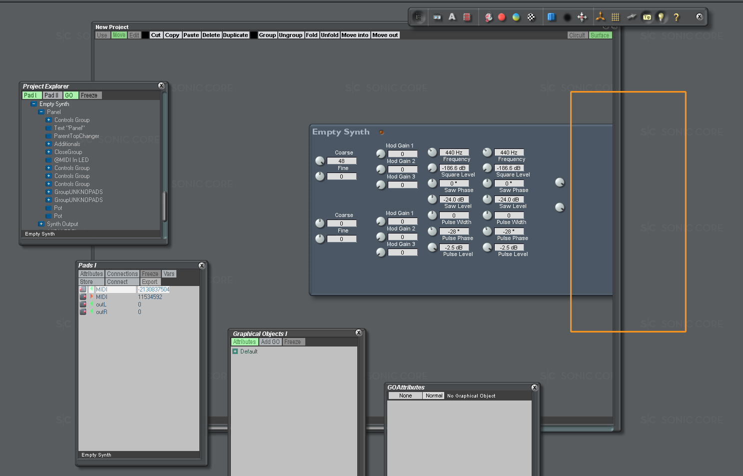

HI !
This is very weird.
2 things:
1/// what surprise me in your pics is that the synth panel seems to be floating like any "normal" surface that is not in "surface edit/move"mode"
I attach a picture that shows my sdk, with the Project window in "surface" mode adfter the Panel was selected : the panel can go "under" the edges of the window, it is not floating above it, but is contained inside the surface mode window.
2/// check that the group is selectable
Select the group (in any way you can, ie in the project explorer ) then, in the Project explorer, click on "Go" to reach the attributes of the graphical object that a group is.
Then, in the attribute, check that "selectable" is checked.
3/// it could be something with sdk7 but I am absolutely not sure of this. Normally, I have the same behaviour as you when the group is "not selectable" . This makes the group "invisible" to the mouse pointer and the panel under it can be selected directly.
If you cannot select the group, you will not be able to ungroup stuff, which is not normal. I Know ungrouping is possible in sdk7 as i tried it myself.
If it is not about selectable group, i have no idea what it could be, except may be that the attribute of the synth panel is not "graphic" but this would be strange as you pobably used the stock "empty synth". Mismanipulations are possible, such as shortcut stroke unvoluntarily. it happens.
You could save your device and send it to me, so i can check what happens.
Let me know !
EDIT; a group or graphical object that has the "selctable" *un*checked, can still be selected in "edit" rather than "move" mode. however, edit mode is a bit more complicated to use as it allows to change the positions of several Gos in a Group or a Go (graphics can be child of another graphic, and when you are back in "move" mode, you can move this ensemble as if it was 1 graphic, ie, relative positions will remain the same (example: the vu meter is made of several "Leds" graphical objects arranged into a group in a child/parent relationships).
This is very weird.
2 things:
Let me know !
- go2.jpg (270.64 KiB) Viewed 49983 times
- go1.jpg (309.11 KiB) Viewed 49983 times

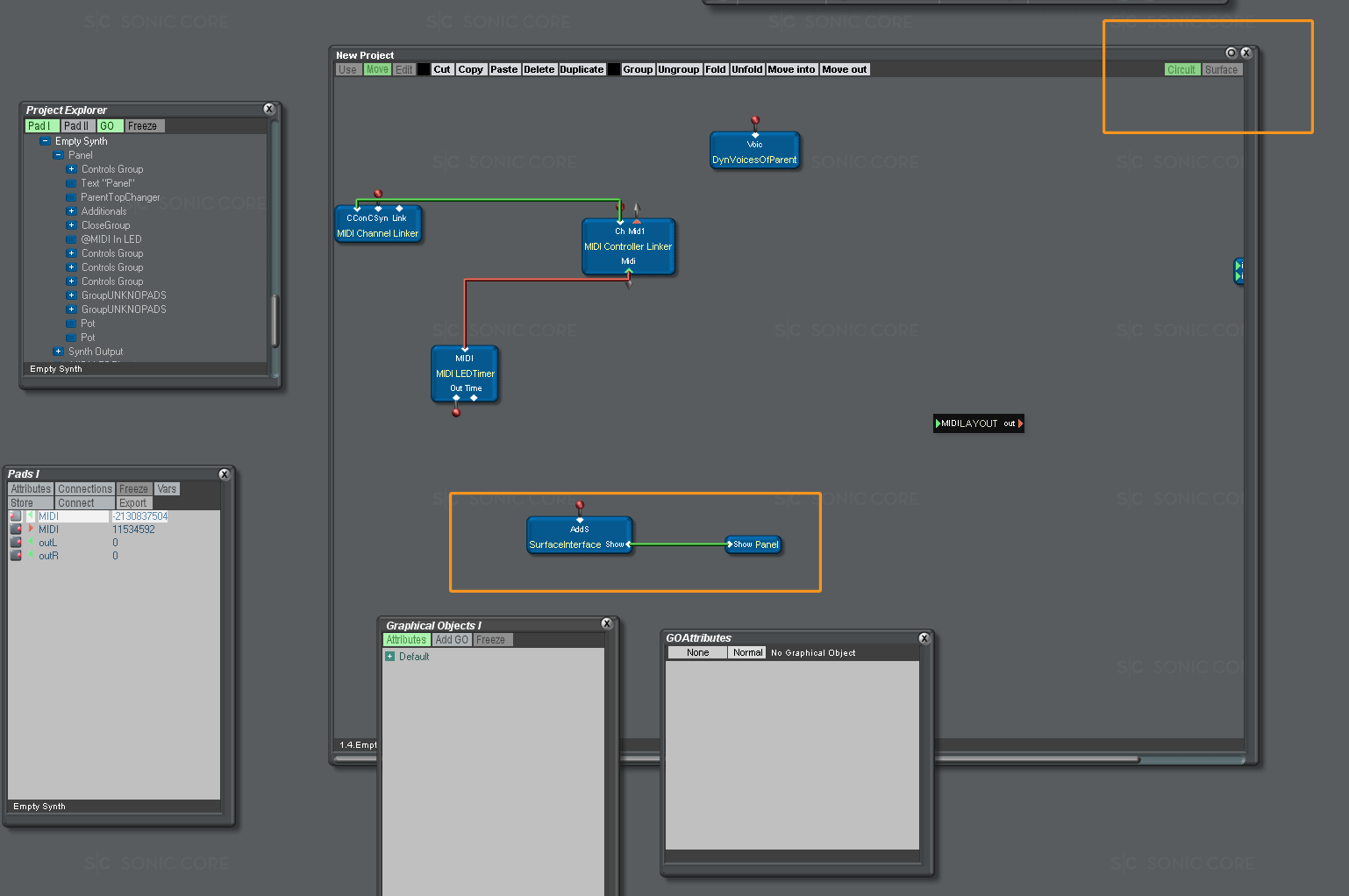

yes, what fra77x says is right too. Might be it indeed. I checked on your picture and it seemed correct to me but i have no way to know for sure.
to summarize
The panels are at the same level as the "surface interface+panel" couple.
the panel module "is" the graphic panel of the device (if you delete it, you loose your device panel and all connections of potis/faders to circuit pads.... so don't delete it lol).
pic attached
The surface must be closed too. if it is "open" it may or may not appear in surface edit view (if you right click the panel in surface view and choose "show" the panel should disappear). it must be closed either by going back into surface view, right click panel (in project explorer) and choose "close" (going back in surface view may "refresh" it and the panel/graphics re-appears) , or by selecting the "Surface interface" or "panel" module, and setting the "show" pad to 0 (if you can't make the graphic panel appear again).
to summarize
pic attached
- surface.gif (109.77 KiB) Viewed 49960 times

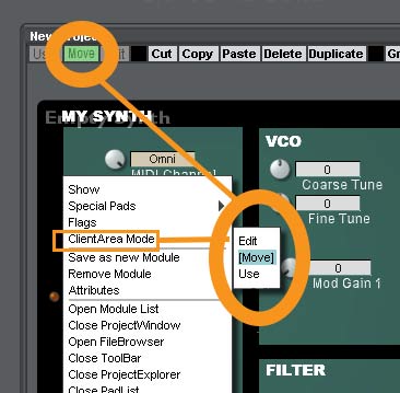

Found another possible cause.
There are two levels of edit/move/use mode
For what we want to do, make sure that
- project window=move
- surface client area mode = move
If project is "move" but client area is "use" , then I do not have dots around the group, i can move it around though.
- sync-move.jpg (26.81 KiB) Viewed 49924 times
