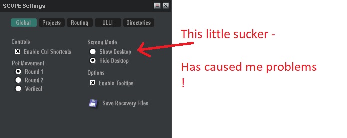

Possibly really random and of absolutely no help at all, but have you tried changing the background thing (you know where scope is incased in its own window or not) set it so it’s not. It’s a stab in the dark due to message moaning about background! 🤷‍♂️

Bud Weiser wrote: Tue Apr 21, 2020 8:06 am
Liquid EDGE wrote: Tue Apr 21, 2020 7:57 am Possibly really random and of absolutely no help at all, but have you tried changing the background thing (you know where scope is incased in its own window or not) set it so it’s not. It’s a stab in the dark due to message moaning about background! 🤷‍♂️
Interesting ...
"set it so it´s not" ...
How to ?
Never did before,- or I´m mistaking you,- possibly.
From memory, I’m not at the studio. But it’s in the global settings (choose view settings and in global tab) Think it says show or hide project window.
Set to Hide it.

Liquid EDGE wrote: Tue Apr 21, 2020 12:25 pm
Set to Hide it.
thank you,- will try !

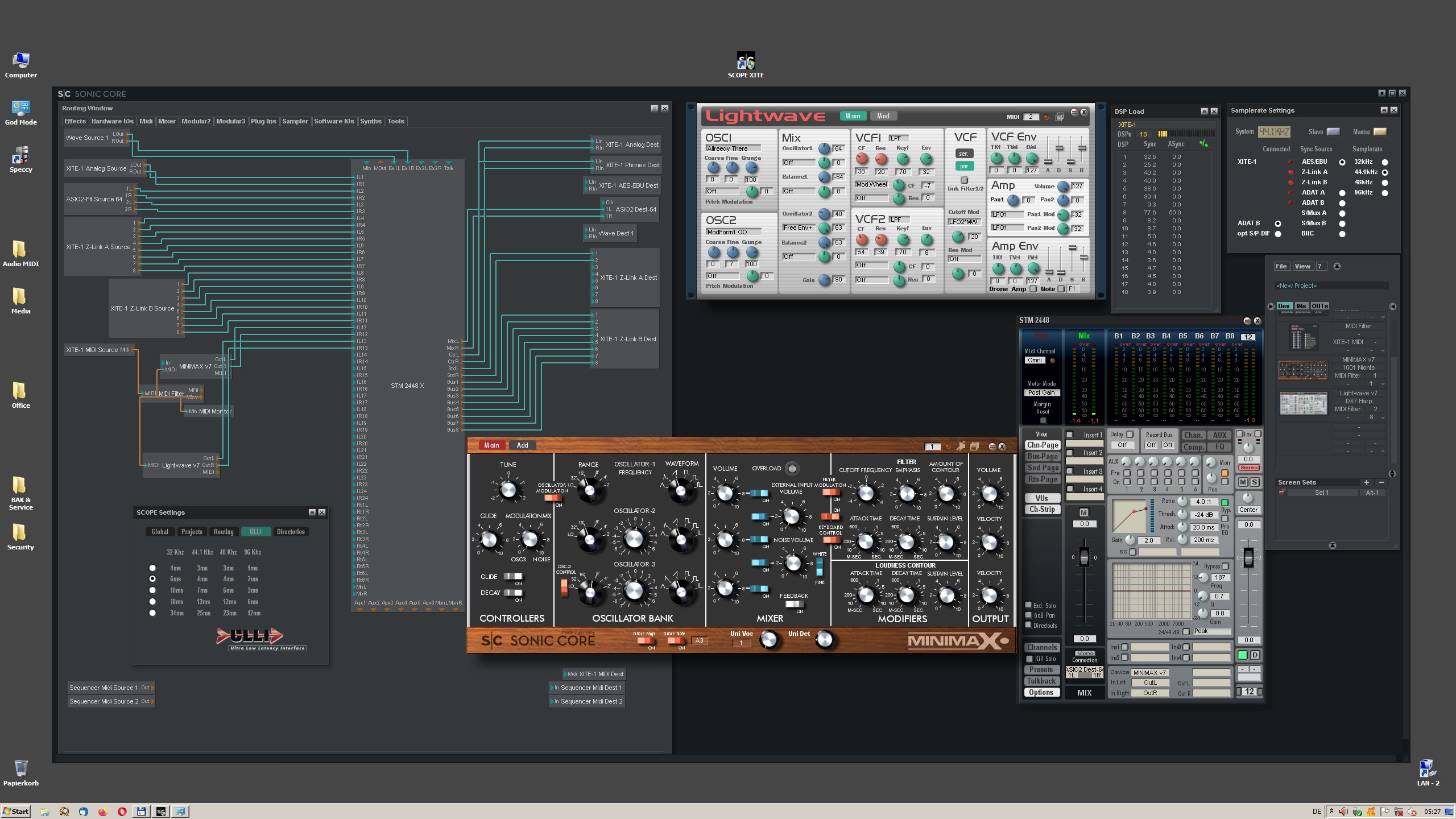

Well, after I changed PCIe slot, I got the same issue.
Now you´d guess my PCIe card or XITE-1 is broken but it isn´t !
You won´t believe,- the culprit is (are ?) the PulsarConfig.pep file(s) you use to configurate XITE-1(D) as "Master" or "Slave" !
As a reminder: S|C readme june 08/ 2012:
Dear Customer,in normal Scope XITE software installation the PulsarConfig.pep in
C:\Program Files\SCOPE XITE\App\Script\PulsarConfig.pep allows XITE hardware to be Wordclock slave only.
If you want to work with XITE as master you need to rename the PulsarConfig_XITE-Master.pep to PulsarConfig.pep and overwrite the installed version.
If you like to work with XITE as WC slave again you need to rename the PulsarConfig_XITE-Slave.pep to PulsarConfig.pep and overwrite the installed version.
Your Sonic Core Team
So, when installing scope_v7.0.1706_x64_xite_deutsch.exe (or EN too ? - I installed the german version !) AND immediatedly overwrite the originally installed PulsarConfig.pep to make XITE work as master because actually and by whatever reasons not using XITE as a slave,- you´ll get the cryptic warning message you´d have to click o.k. and then, nothing works !
So, this time, I saved the original file before overwriting and after I got the same issue, I deleted the overwritten and put back the original, re-launched SCOPE and voilá,- it worked as MASTER !!!
Means:
With SCOPE 7.0.1706 x64 installation, XITE-1 works as MASTER,- not as Slave and all ASIO, MIDI, Z-Link w/ A16U, samplerate settings and DSP/Async display works in standalaone as you see in the pic.
What you don´t see is w/ ASIO it works flawlessly w/ 128samples/4ms/44.1K (ULLI),- so now I was able to set SCOPE ASIO in Reaper 6.08 and Studio One Pro 4.x, so I guess it will work in Reason 10.4 and 11.2 too.
I´ll have some more work left here ´cause I´ll try in the former PCI-E x4 (x2 when Ultra M.2 slot is active) again.
But NOW´s the question if the PulsarConfig_XITE-Slave.pep file, we´d have to rename, then overwrite again to make XITE a BNC slave, is also outdated/incompatible or whatelse ???
I´ll try to make XITE-1 a BNC slave soon and by using SCOPE settings "Slave" button instead a file.
Maybe that works now w/ scope_v7.0.1706_x64_xite.
I really wonder if the user experience XITE not working as BNC slave, also together w/ A16U, come from using these old PulsarConfig.pep files ?
SCOPE_XITE v7.0.1706 x64 standalone WORKS.jpg (718.28 KiB) Viewed 20687 times
Interesting ...
How to ?
Shown here ….
Scope 7 issue
Scope 7 issue
Scope 7 Issue.jpg (28.88 KiB) Viewed 20611 times
