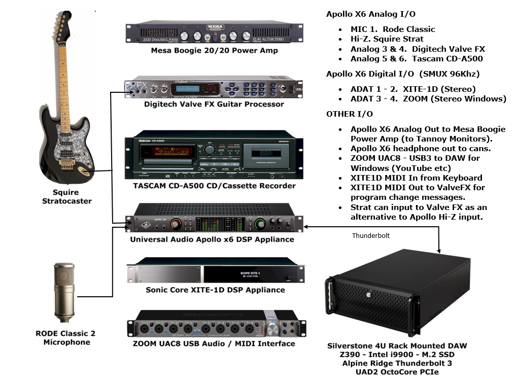

UPDATE - I've now reconfigured my Rack around the Apollo I/O (All sound sources now available via UAD Console), including reconscripting my Digitech ValveFX and using the ZOOM as a windows soundcard for things like YouTube, plugin shop Soundcloud demos etc. Guitar and MIC able to use Unison slots for impedance matching etc.
Battle DAW Update
Battle DAW Update
battle daw update.jpg (215.69 KiB) Viewed 3430 times
