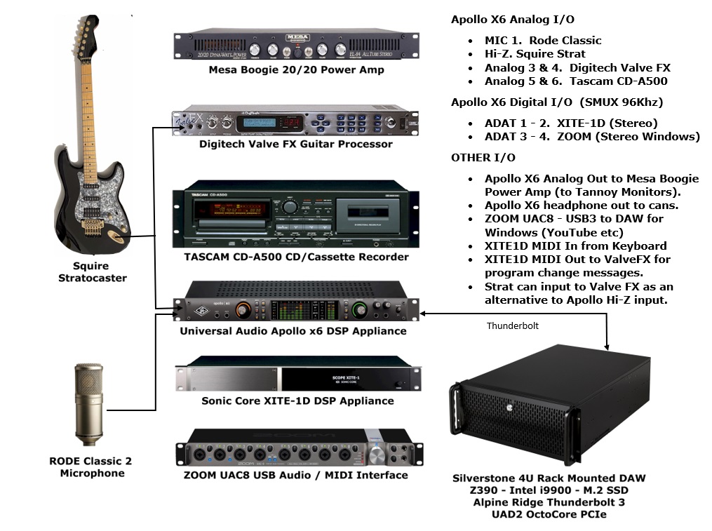

UPDATE - I've now reconfigured my Rack around the Apollo I/O (All sound sources now available via UAD Console), including reconscripting my Digitech ValveFX and using the ZOOM as a windows soundcard for things like YouTube, plugin shop Soundcloud demos etc. Guitar and MIC able to use Unison slots for impedance matching etc.
