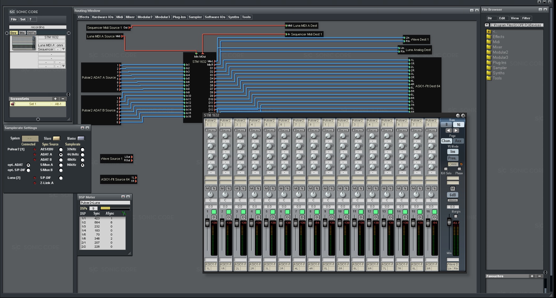

green led on the a16 master and 96khz
- screenshot.jpg (498.34 KiB) Viewed 5538 times

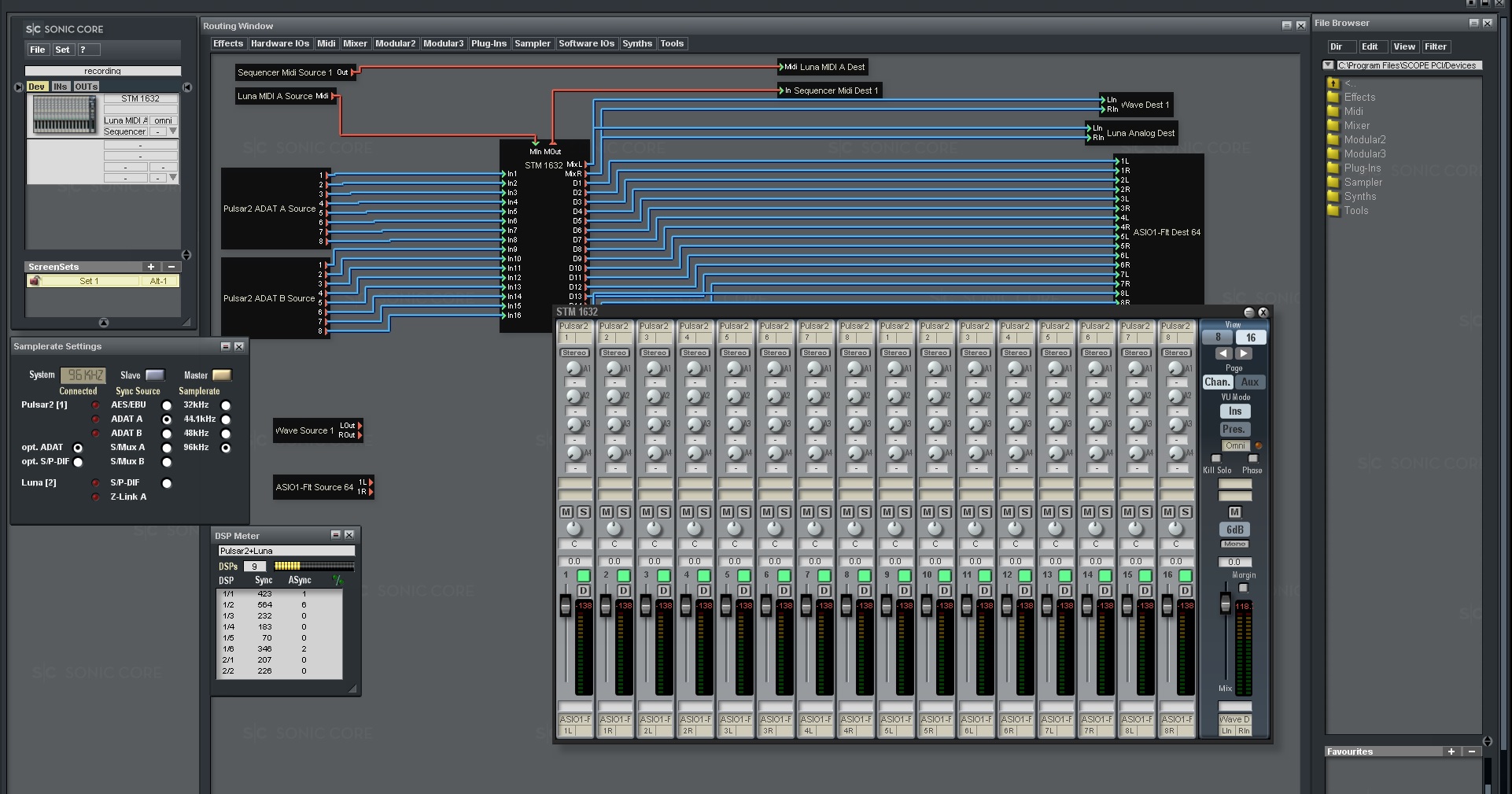

red led on the adat selection of the a16
- screenshot 2.jpg (490.2 KiB) Viewed 5533 times
