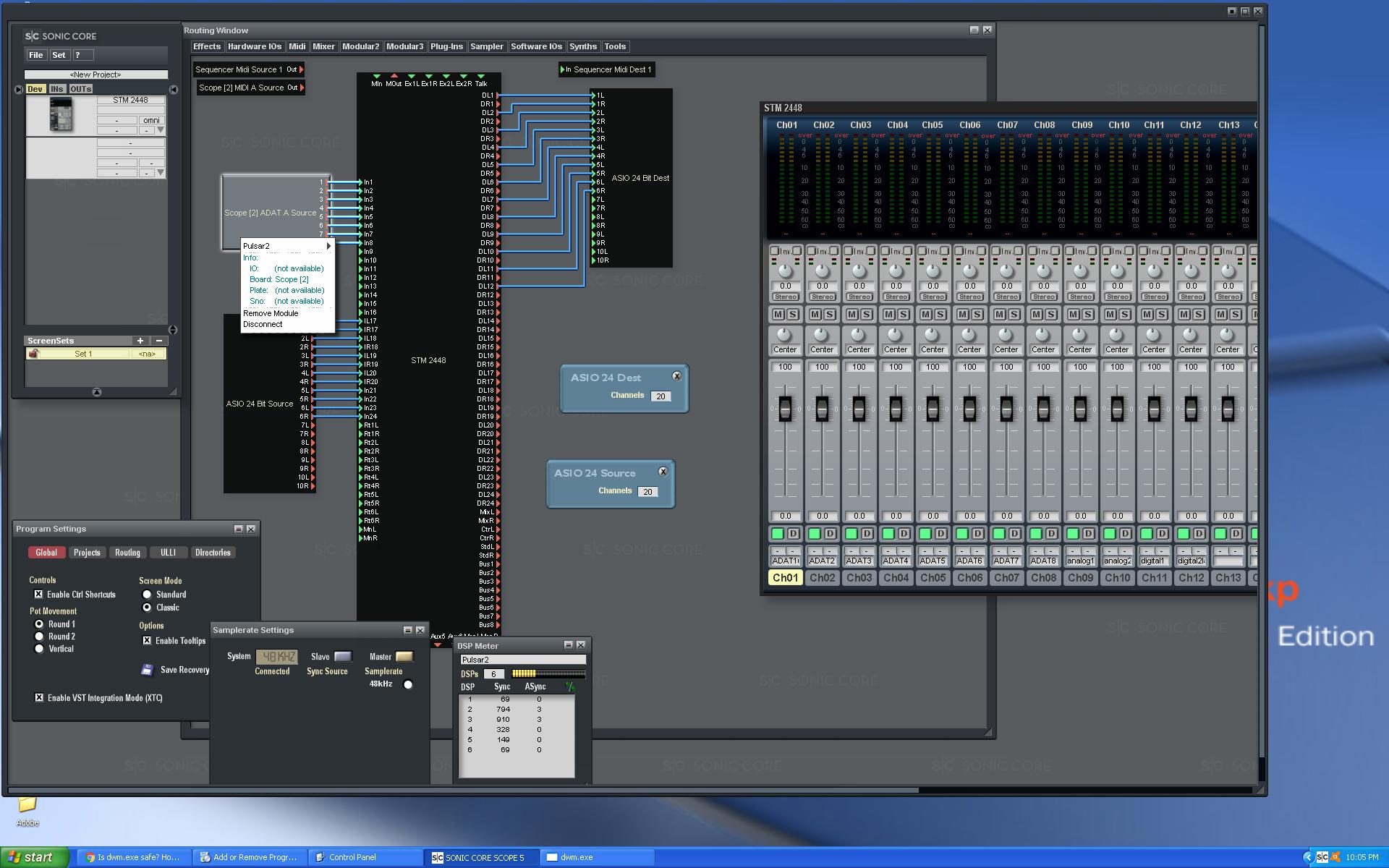

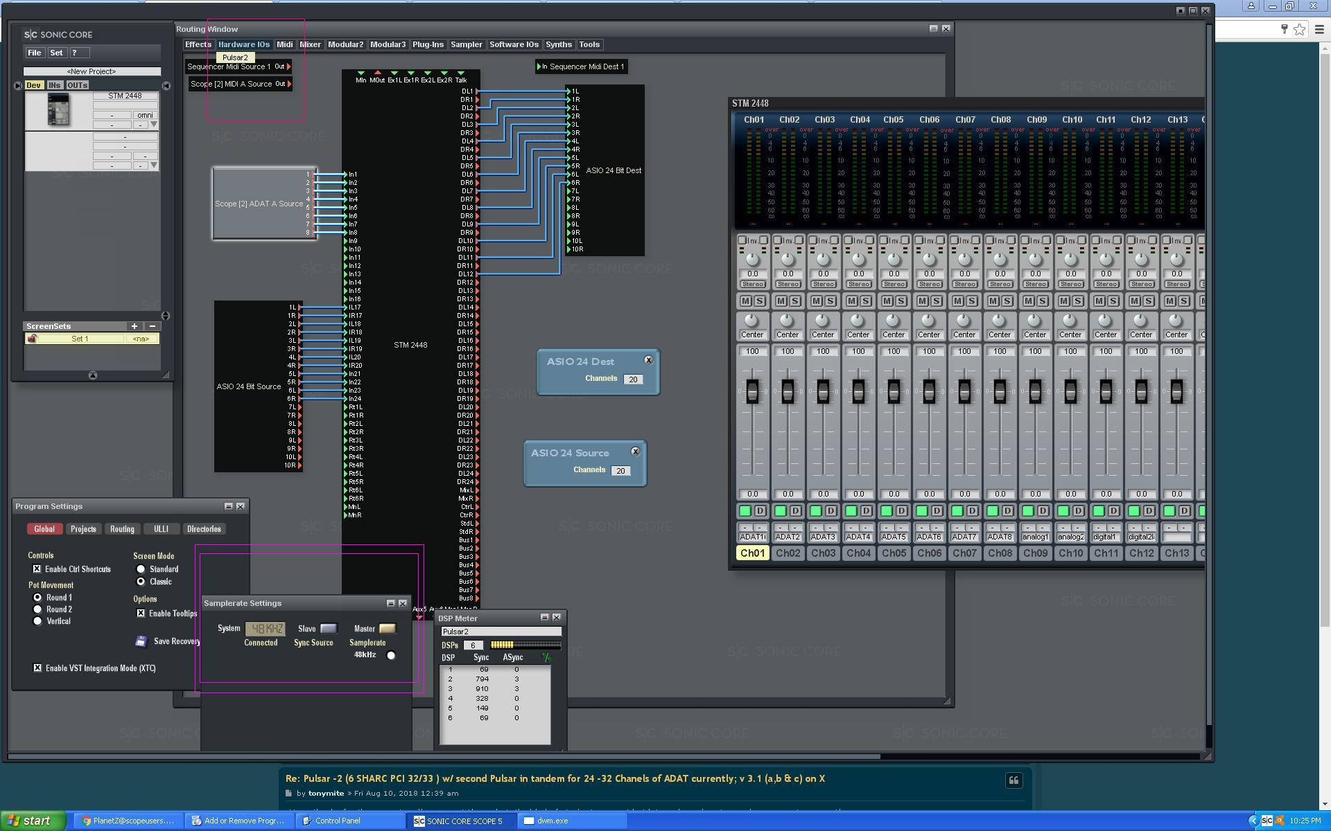

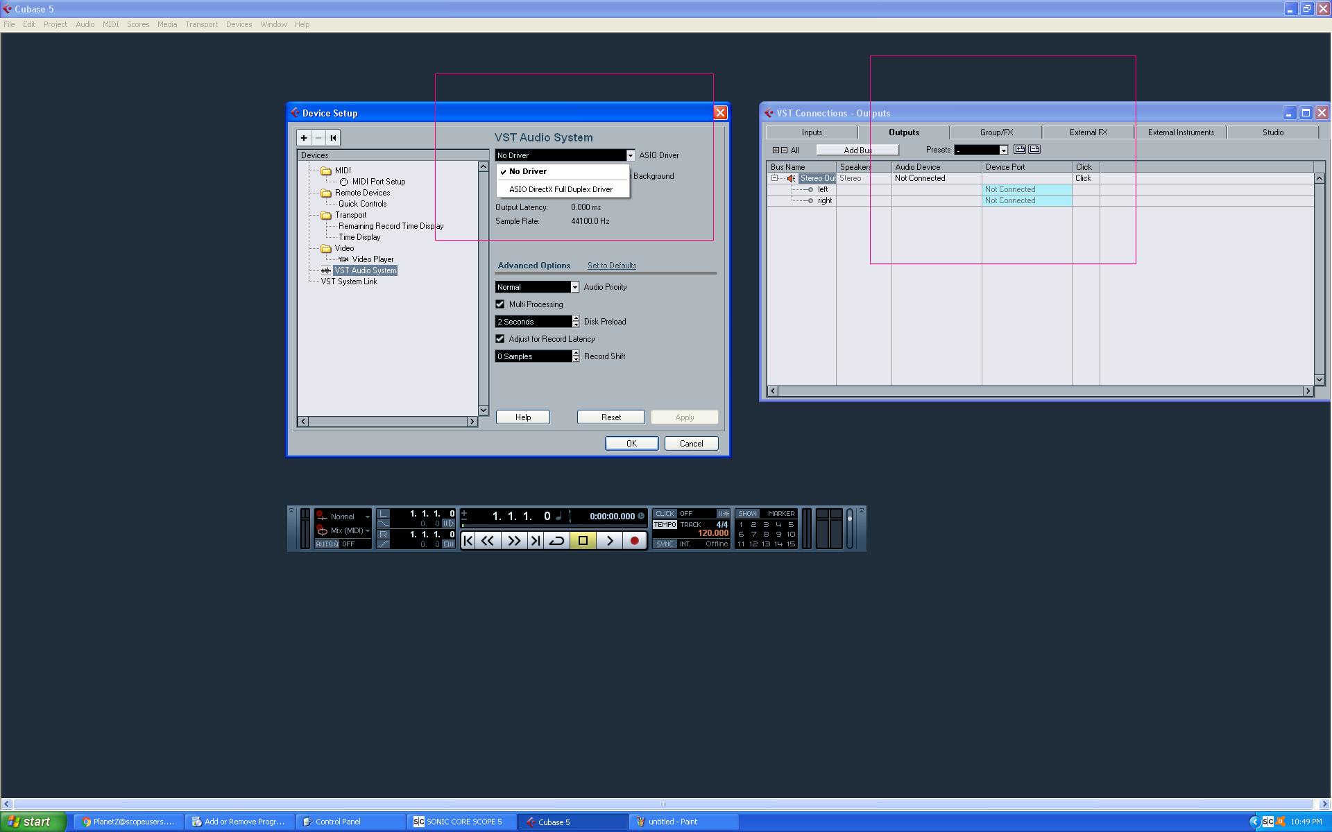

Hi guys,
I'm still stuck - as you can see via attached screenshot;
1) - Besides Adat port not receiving audio via Adat lightpipe from Adat HD24XR, (I've tried both Adat ports)
2) Sample Rate options do not appear except 48kHz,
3) I/O: Not Available (Incl Pulsar 2 Hardware I/O)
Any Ideas?
Any Help is Help - Thanks in advance.
Any Ideas?

Re: Pulsar -2 (6 SHARC PCI 32/33 ) w/ second Pulsar in tandem for 24 -32 Chanels of ADAT currently; v 3.1 (a,b & c) on X
Have you already tried to remove the card, reseat the io board and put it back in place on the pc?
It must have the io plate recognized and working, otherwise there is a good chance that there is a hardware fault.
IMHE I would say ditch the Steinberg generic ASIO driver, disable or uninstall in Control Panel. Seat your cards. Reboot and check Control Panel for Scope PCI Drivers. If there, configure in Control Panel. If not reinstall Scope. You might also try VoiceMeeter and see if it recognizes the Scope Drivers after you do the above.
perhaps there is something wrong with the new card.
there are no special tricks. if you have a matching pair of ASIO modules in the routing window before opening Cubase, and if the Scope drivers are shown in the Device Manager of Windows, then Cubase MUST see it.

Gary, what's the name of the i/O enabler app under v5.1? He needs to run that to re-install ASIO, no? Either way, it seems to me that ASIO is not registered with the system yet.
Also tonymite, You don't need 20 WAVE devices unless you're going to be doing some crazy recording via Wave/MME in Wavelab, and I suggest setting that to 24bit instead of 32bit (the first screenshot on the previous forum page shows that on the properties>settings tab). Some, if not all of that, is also changeable on the I/O enabler app, but I can't recall exactly what.
Once you get that far, ASIO will work much better, and hopefully my above (top line) question will help get you there. Once the driver is properly installed, it WILL show up in Wavelab & Cubase but I recommend adding it from the Software I/O's tab, and knowing which ones to use. ASIO2 24bit Src, ASIO2 Dest is what I use, and you can simple double click the Src to change the number of input & output channels (they don't have to be the same), BEFORE opening your intended recording or DAW application. I don't recommend changing them with your app in the background.
