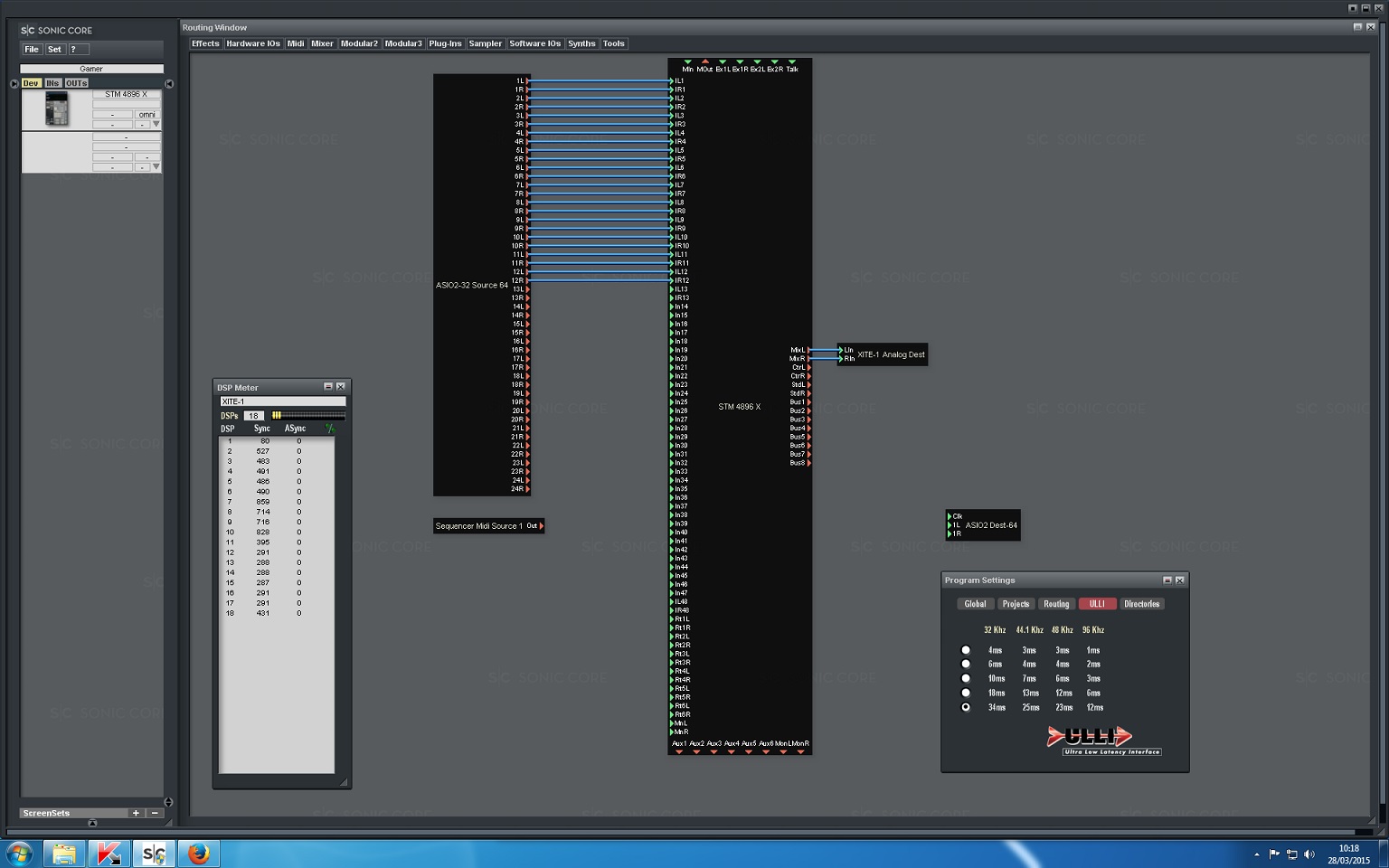

This is my default project:

Tried all ASIO settings. 25ms was too long for ASIO Guard so only tried the middle three settings: 13ms, 7ms and 4ms (I figured it was pointless trying 3ms). Always the same PCI limit error.
