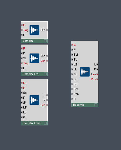

and now I remember why I didn't bother to check the rest of the reaktor samplers for audio rate start time inputs:
>>control rate sampler gate/trigger inputs!!
a nogo for my tasks, check demo, kindergarden it is indeed.
still, once I tried to get the effect supplied within the demo, with reaktor, and it sounded just horribly thin, maybe some interpolation going wrong, and maybe because of the max 3200hz polling rate for the gate to audio conversion I had to apply, if I remember correctly
don't try to tell me reaktor is not a toy, but I have to admit it is a quite stable reliable average toy for the everyday musician, just like a volkswagen, right? gets the job done, but does not excel getting it done, nor does it shine.
Screen Shot 2015-01-20 at 12.51.06.png (15.24 KiB) Viewed 25975 times
