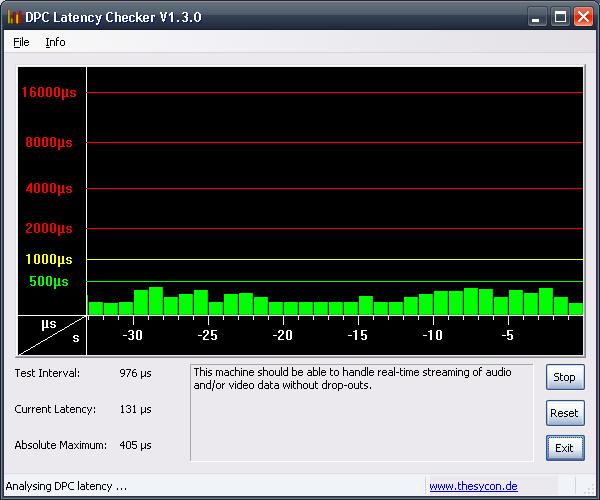

only for information ..
latency checker is displaying this while scope and ableton are playing.

Your dpc latency appears fine. Long as there is no huge spikes taking you into the red and increasing your 'Absolute maximum' to a very high number. Your Absolute Maximum is 405us wich is'nt great but sufficient for most situations i think. Just make sure you let the dpc latency checker run awhile if you did'nt cause sometimes things can appear fine for awhile then a huge spike appears.
It's probably as you suspect a conflict of hardware using irq. If you buy another computer try to get proven motherboard and graphic cards, don't install any unnecessary software that come with your motherboard's software.

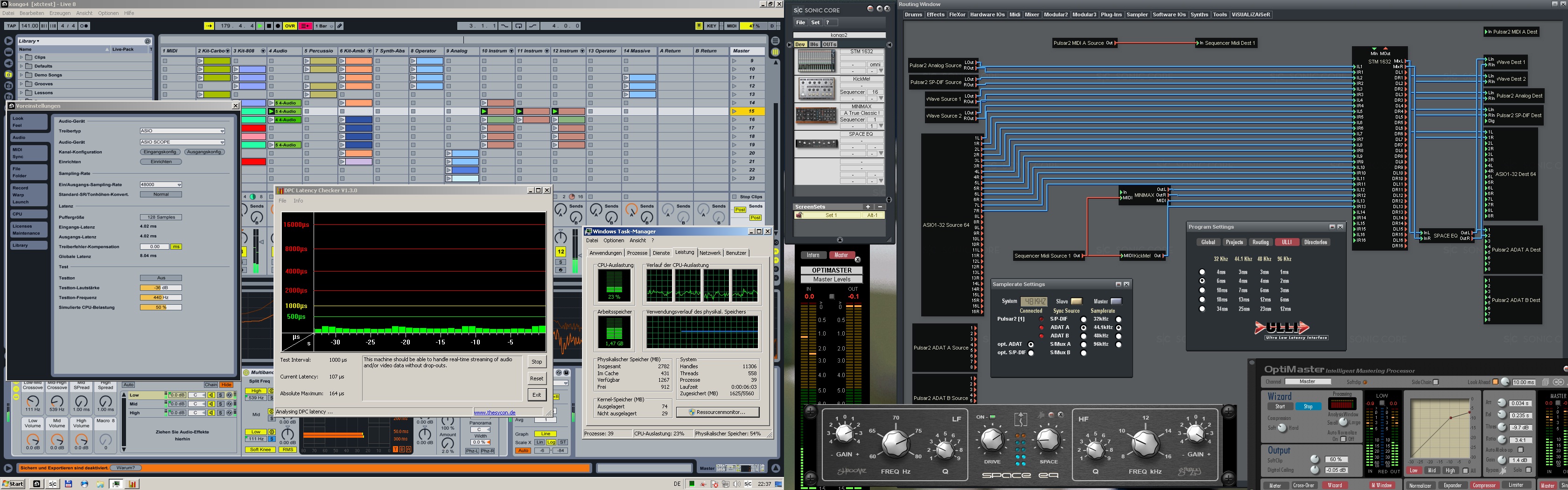

ASUS F2A85-V no shared interrups ..
A8 5600k
each ScopeII on its own IRQ.
Latency checker displays maximum 216uS
Win 7 Fancy GFX off.
15 Masterverbs.
Ableton is still crackeling with Latency under 12ms.
with 20 and 40% CPU usuage.
Scope is only acting as mixer and FX .. drums synth from ableton

Re: Asio Crackeling
the cpu usage meter is not accurate.
post a screenshot of your routing window and audio driver settings in Live.

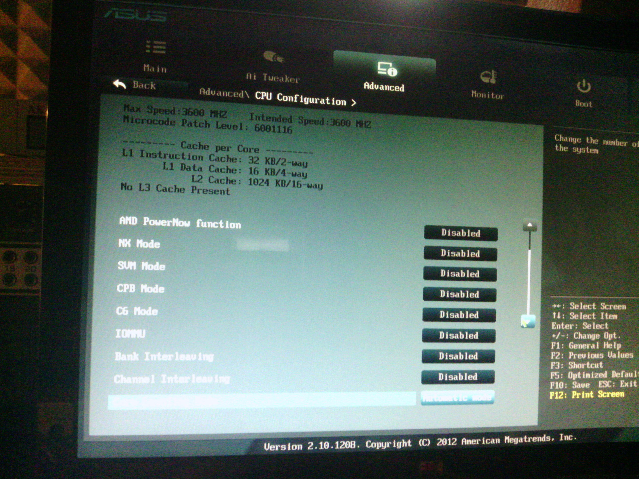

Now on the AMD FM2 .. i have also disabled all bios tweaks regarding the CPU. I have no antivirus. And the latest drivers.
No wifi, but i will try all the things that are postet here.

i will attach a screenshot of the bios settigs.. in a second.
