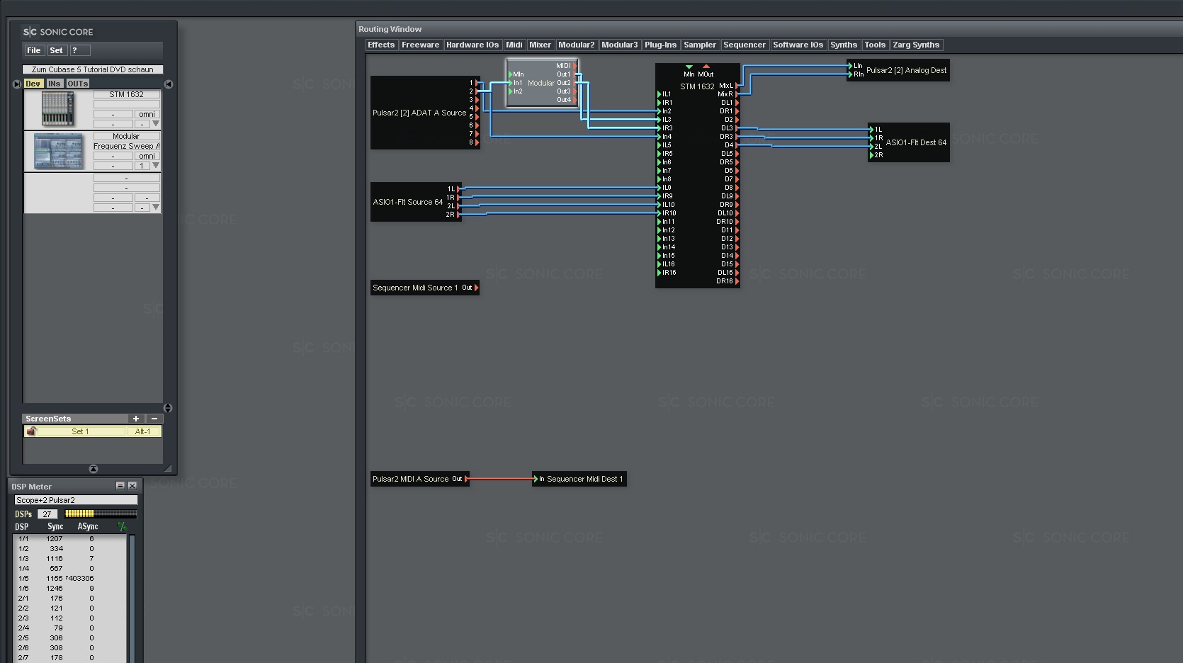

The cards were working now for a few days, i have found the right order i think, and updated the bios.
But now i have got the same error again and found out, that it seems to have its cause in a strange async error inside scope.
Can someone confirm that such a number( DSP 1/5) is some error?
DSP async error.jpg (174.76 KiB) Viewed 2058 times
I dont know what the numbers in the DSP meter mean exactly, maybe someone can find out why i have such errors, they dont occure everytime i work with SCOPE but frequently.
I am happy for every help.
With kind regards,
Manuel

Post by fidox »
I guess , that this is not the problem.
I have the same async numbers (similar) like you, and my cards works normal fully loaded.
Re: Driver for Powerpulsar 15 DSP
async is traffic between the cards and the computer system. your modular patch uses computer resources as well as dsp resources.

I tryed to open SCOPE in windows XP mode, and it works fine again, lets see how long.
But i belive the Async number is a problem, becouse now SCOPE runs normal and the number is 2344.
I saw also that when i opend the patch before, the async nummber grew constantely and endet in the PCI Master Abort error.
I bought a fan today also, so i hope for a problem free time....
