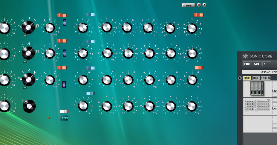

1.) Today I've tried STS5000 (which was included in the 5.1 Upgrade) to find out that Win7 also has a BSOD IRQ_NOT_LESS_OR_EQUAL. As soon as I send the first midi notes to STS I get the BSOD.
2.) Miniscope MKII opens without background, only control elements show on screen. So I can confirm a previous post in this thread.
Minor nuisance
1.) I use a dual screen setup with scope routing window on the second screen but Popups always open on main screen.
Anyone with solutions to this?
