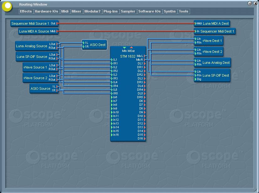

Geoffrey Taucer wrote:I'm using Sonar.
Any chance you could give me a screenshot of what the routing should look like for the amplitube standalone to work? I've attatched a shot of how I have it set up now.
There's some obvious faults to your project there.
Try this:
1. Luna Source -> ASIO Dest
2. ASIO Source -> mixer -> Luna Dest
3. Use Luna source/dest of choice. (I don't know what preamp you use.) BTW, how are you pluging your gutiar into your computer?
4. Run Amplitube live, or Sonar.
If this doesn't work, try different ASIO drivers - the ones with the 1 or 2 prefix. In fact, _do that now_. Those old ASIO drivers you use are provided for legacy support.
Try this:
Luna analog source and dest or sp-dif source and dest? After hooking it up the way I think you're describing, I still have the same problem (screenshot attatched -- got analog input currently routed to ASIO dest)
Guitar -> mixer -> soundcard input
How do I switch to different ASIO drivers?

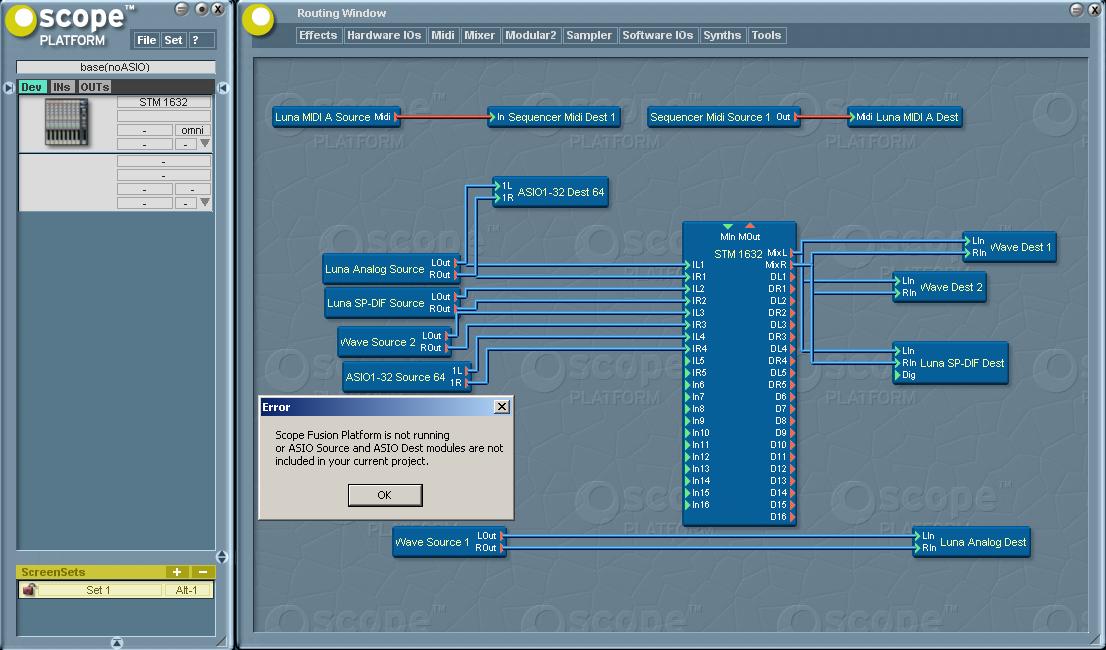

You should hook up whatever hardware inputs you are using to the desired software destination. In your case Luna Analog Source.
Anyway, the connection is correct as displayed on the picture.
You change ASIO driver by loading a new one. See under "Software IOs".
You need a source and a dest of the same ASIO type. Try ASIO1 or ASIO2-FLT 64 source and 64 dest.

Post by Geoffrey Taucer »
I think I'm getting the hang of the routing. THis is pretty cool!
Still haven't been able to get any ASIO apps to work yet, though.
EDIT: here's my current setup. Still no functional ASIO

Uhm, try the "64" drivers instead.
You mean that when Scope Fusion Platform is running and you load up Amplitube live, you can't select the "ASIO SCOPE"-driver from the prefs?
Maybe you should run the installation again. Perhaps the driver isn't loaded in your system.

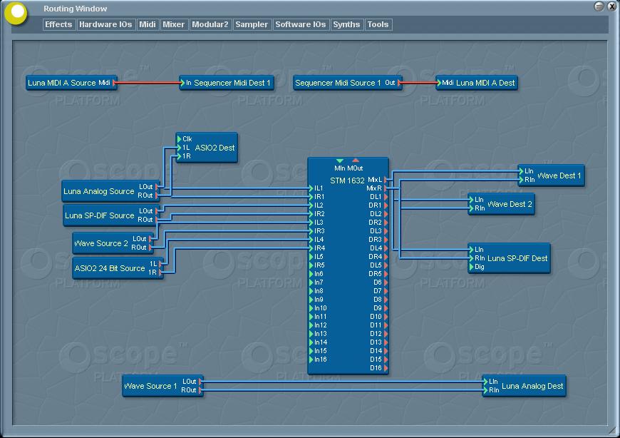

Geoffrey Taucer wrote:I think I'm getting the hang of the routing. THis is pretty cool!
By this you mean that you are still getting the no asio modules loaded error in amplitude? I think just to get this sorted out just create a project with nothing but ASIO Source and ASIO Dest modules (no connections to anything) to start with until we get that error sorted out.
Regards to your last screenshot. Send your mixer output to Luna Analog Dest if you are monitoring via the analog outputs of the luna card.
And yes, the routing is very cool. It is one of the most powerful features of Scope.

Nothing I do seems to work; I'm starting to think this might not have anything to do with the routing, though I have no idea what else could be causing it; the problem occurs with any ASIO app I try to run.
Here's the exact error message:
"Scope Fusion Platfrom is not running or ASIO Source and ASIO Dest modules are not included in your current project."
As you can see, neither is true.
