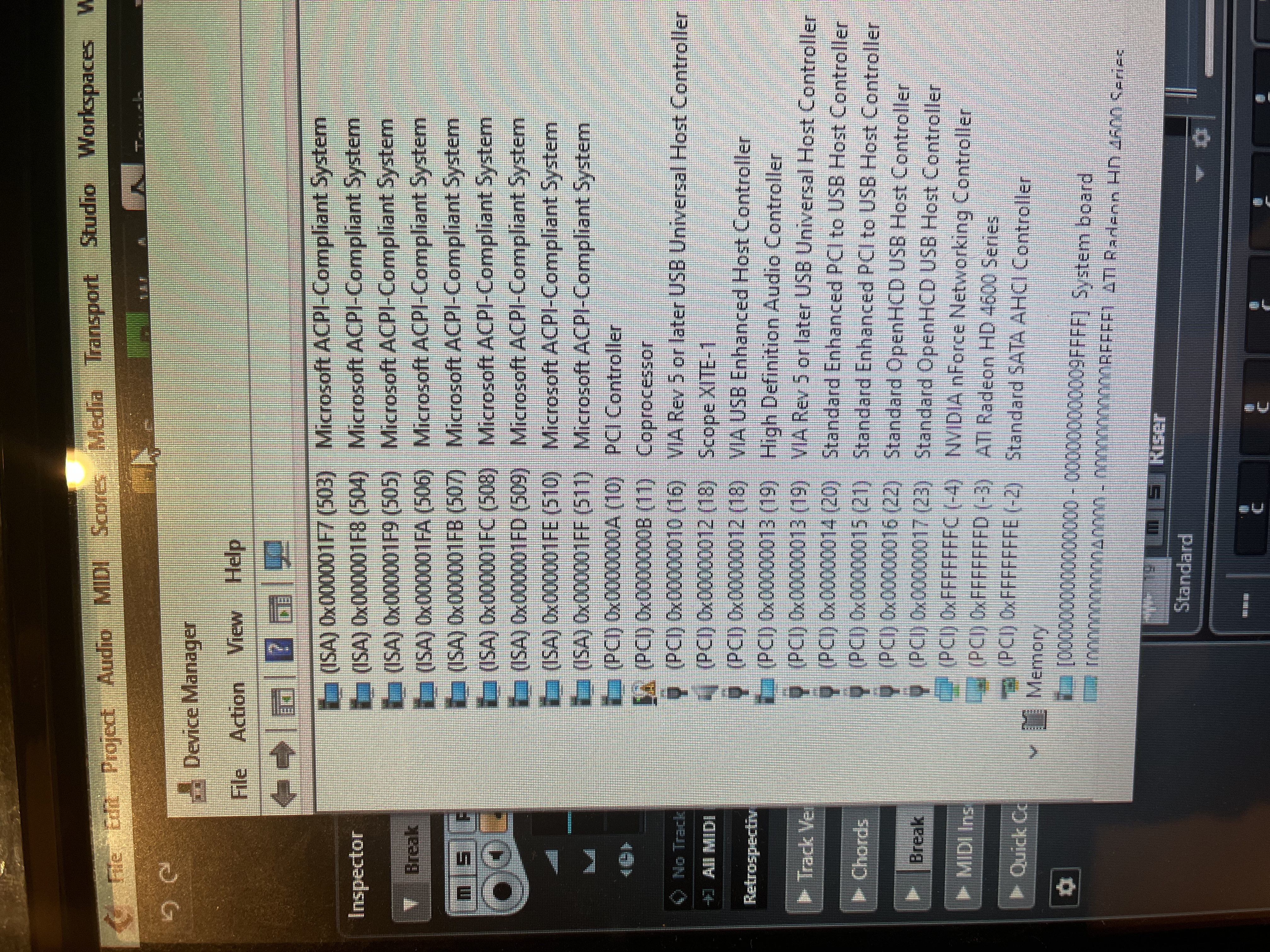

Re: How to optimize windows 10 for Scope to avoid clicks and pops!?
There is something on the same irq as scope.. totally forgotten how to change or if you can irqs.valis wrote: Mon Feb 14, 2022 3:19 pm Type into Windows menu (or Search bar) on Win10: System Information
I think that’s the usb pcie expansion that my Virusti2 is connected to.valis wrote: Mon Feb 14, 2022 3:19 pm Type into Windows menu (or Search bar) on Win10: System Information
Expand the Hardware Resources and check the Conflicts section.
- 8099DACC-DD39-4394-ACAF-F132149825B6.jpeg (8.1 MiB) Viewed 32438 times
Yes try disabling the VIA USB on interrupt 12 which is shared with Xite, you should be able to right click on it and disable it.then just use another usb slot for anything that is connected to that, from what you said above your Virus is connected to that but try moving it to another usb socket that isn't sharing with Xite? In fact I would remove the virus first then disable the VIA USB
