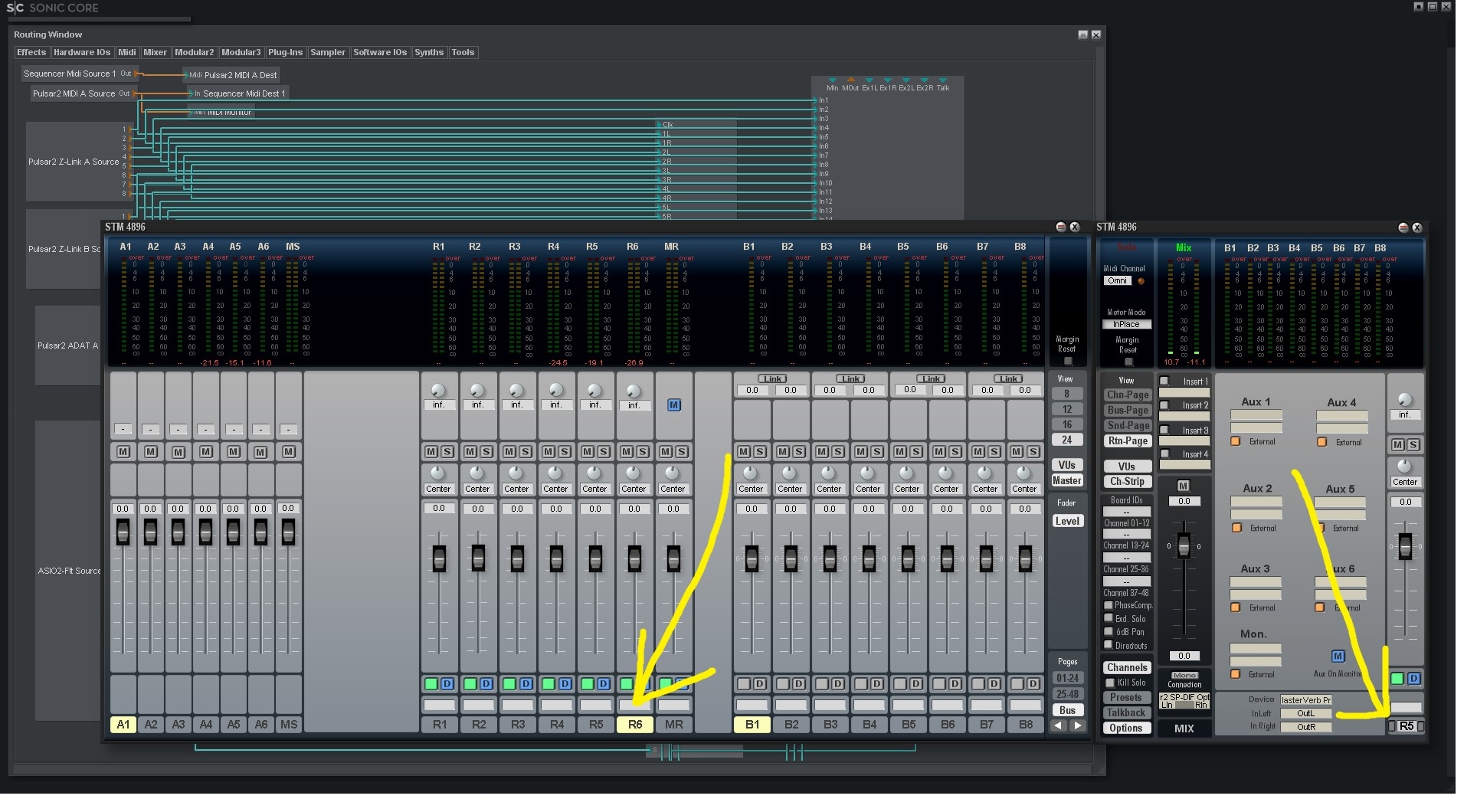

Silly bug, in 2448 and 4896 mixer on Rtn-Page, the Return 6 have wrong name, it's R5 instead R6
See attachment picture
Another thing about send/return (not a bug), 4896 mixer start as default with all (R1,R2,R3,R4,R5,R6,MR) Mix and Defeat "disabled", 2448 start as default with all (R1,R2,R3,R4,R5,R6,MR) Mix and Defeat "enable". This take me a little bit of time to understand why send/return not work on 4896 at the beginning.
- Picture.jpg (495.8 KiB) Viewed 118471 times

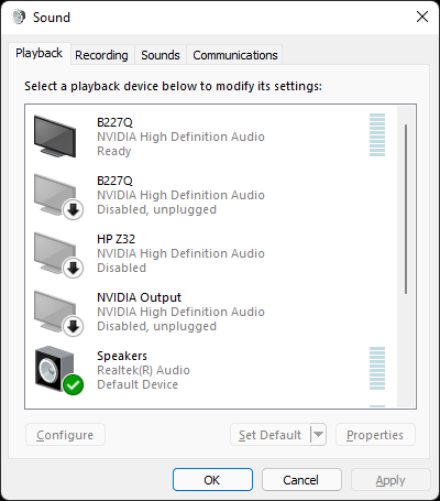

Don't know if this has been reported already.
The left and right on the Wave Source 1 seem to be interchanged by mistake. I don't know if the same mistake is made on other software IOs.
So the left signal comes out of R Out and the right signal comes out of L Out.
Due to this bug, you have to cross the wires in the current Scope 7 to connect left with left and right with right - as shown in the screen shot.
What version of Win10/11?
If you can find the following properties panel You can control speaker configuration, panning, and sometimes flip the left & right balance.
- 2022-02-20 (3).png (24.91 KiB) Viewed 115970 times
