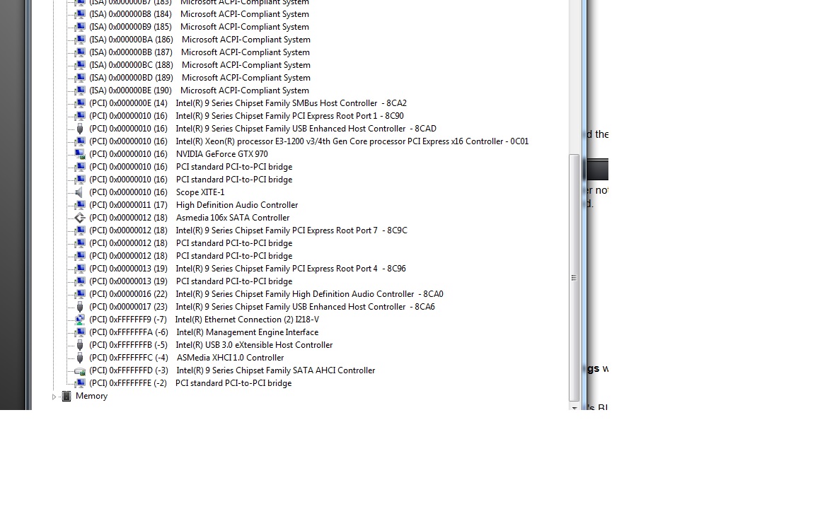

Mr Arkadin, could you please post an IRQ screenshot of the new machine for reference?
Dante, when you say you're getting 50 channels at 96kHz, are those ASIO channels or mix channels in Scope, the sequencer or a combination?
Could you post the complete hardware specs for that setup?
I've always had the impression that 96kHz is difficult to get stable and crackle-free when there is more than one DSP card.
Re: Anyone successfully using Cubase Pro 8 with Scope on XIT
frokka wrote:Mr Arkadin, could you please post an IRQ screenshot of the new machine for reference?
Sure thing.

There is a significant difference between the two versions.
The negative values at the bottom end are the devices using MSI – which is Message Signalled Interrupts, not to be confused with the Micro-Star International hardware company :-)
So there is an ongoing generational transition from the original physical line interrupt to the new MSI, and most likely compromises are made that unfavors the old IRQ scheme, which then are different among the boards.
On the first computer setup neither the GTX, USB 3.0 nor the SATA controller is using MSI.
Also notice that on the functional computer the XITE-1 is sharing IRQ with an USB controller and the most resource demanding unit on the bridge; the GTX graphics card. What does that really say about the risk of IRQ sharing in modern computers? In my opinion the problems that remain in some setups after disabling all the C-states are probably related to a mismatch of resources allocated between IRQ and MSI slots, or perhaps device drivers that are not optimalized for the current interrupt environment. Avoiding the IRQ sharing is therefore not a remedy for everyone.
It's possible on some devices to change from IRQ to MSI via the registry, if the driver supports it.
MSI have less latency than IRQs and are optimalized for multi-core / CPU hosts, which of course IRQs never were.
Also note that MSI has a never revision: MSI-X that was introduced in PCI 3.0 and is more efficient than regular MSI. Perhaps the newer boards will work better with older devices because of this.
http://forums.guru3d.com/showthread.php?t=378044
http://en.wikipedia.org/wiki/Message_Si ... Interrupts
https://msdn.microsoft.com/en-us/librar ... 85%29.aspx
/frokka

I won't post IRQ details of my new comp. here, but Xite is not sharing its IRQ anymore.
On the previous mobo, I had IRQ16 sharing Xite, a GTX450 and a USB Host and had a lot of troubles (BSODs after minutes, sometimes hours of running time).
my current MB model: Asus Maximus VII Ranger (blabla) on Z97 Express chipset. Works like a charm.

Well I didn't understand most of frokka's post but I hadn't even noticed the shared graphics card. It hasn't caused a problem yet (although I haven't tested it in a proper session with loads of tracks yet do time will tell). I have two other x1 slots on this motherboard so I think I'll be all right if I start developing any issues.

Mr Arkadin wrote:Well I didn't understand most of frokka's post..
Sorry about that, I'll try to make it clearer.
There is an old and a new way of dealing with interrupts.
Both has to coexist on the same system.
The new way (MSI) is better suited for modern computers and has less latency.
I can't tell exactly why your first computer didn't work, but it's clear that interrupts are handled differently on the new computer, and I think the newer motherboards are better for Scope because of MSI.
The motherboard drivers that are made these days are implementing and activating MSI by default.
/frokka
