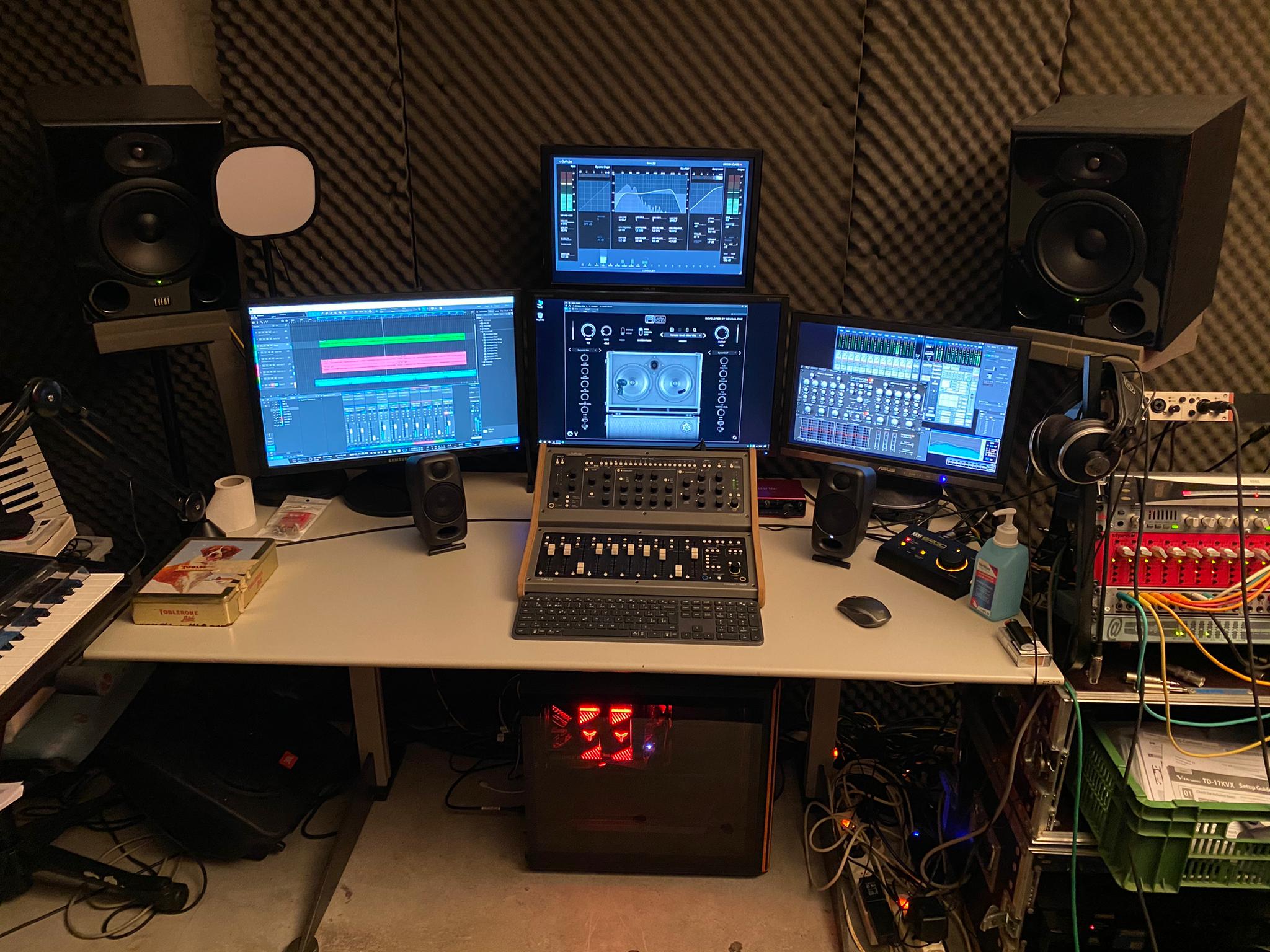

Hi guys,
I can confirm the following setup works like a charm, I also added a dedicated GPU instead of the onboard Intel Graphics, now with 4 displays connected :-D First, I wanted to use my old Matrox M card, but it's too old and I've had lots of problems with native Plugins using OpenGL...
Also, for the first time, I got no crackles with the Scope Wave Driver, which is brilliant :-D
Ok, here's the final config:
Chassis: be quiet! - Silent Base 801 orange | glass window
CPU: Intel Core i7-10700K | 8x 3.80 GHz, 16MB L3-Cache
Mainboard: ASUS ROG Strix Z490-G | Intel Z490
Grafics: ASUS GeForce GTX 1650
RAM: 32GB Corsair Vengeance LPX DDR4-3000 | 2x 16GB
SSD (M.2 / PCIe): 250GB Samsung 970 EVO Plus
PSU: 550W - be quiet! Straight Power 11
and here's a Pic, please don't look too close what's going on with cables under the desk ;-p
Cheers,
Roman
t_tangent

Posts: 2929
Re: XITE-1 PC CONFIGURATION REFERENCE
Looks great !
Was it essential not using iGPU graphics ?
I understand "GeForce" means Nvidia drivers,- no ?
In WinXP times, these were the best,- but nowadays, I read everywhere Nvidia drivers make problems in audio DAWs.
Was that "fake news" ?
Posts: 7746
Gaming GPU's *can* do this, different driver versions and card combos will give you different results. Typically what happens is they set an extremely high priority to their driver/process to get a few more FPS for your games, and other tasks can suffer. Also each company has an awful lot of background tasks in this era, but that applies to Intel as well so there's no escape there.
You can do more minimalist drivers, but the best option is to opt for the Quadro/FireGL. The branding has changed for both of these lines from Nvidia/AMD both but it's the same basic concept which is: Workstation & "Clean" office installed computers with drivers that are vetted for work and not just play.
Since we have no need for the latest & greatest, finding a still supported Quadro that runs cool & low power (used or new) can give you similar gains with low cost and low thermals. The only real gotcha is that I'm finding more and more audio apps are using a lot of GPU calls for scalable interfaces, vector interfaces & the like. So getting something from a more recent generation may have more longterm advantages than in years past (going back 1-2 generations at most). It only saves you a lot of money if you go used now anyway, so no biggie if you get a last-gen card that runs under $300 and you're only doing audio stuff.
