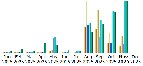

Also, you can check the number of people currently listed online, and look at the guests. Some portion of the attacks are establishing a full https connection (like .01% or less) and you'll see anywhere from 400-1200 listed as online. I reset the logs so it doesn't show in the graph for this year (posted earlier) but in Jan/Feb the previous round of attacks was reaching 6000+ bots and so you'll see "Most users ever online was 9652 on 01 Feb 2025 16:05". That's when I implemented cloudflare free.

Most likely moving to full scanning prior to forums entry, contacting provider now (I didn't enable this even with the paid platform features because it requires help from hosting support and they are...challenging to communicate with after 3 buyouts). Playing wackamole has helped cut down on a lot of the IP addresses inbound, but the new ones that are being spun up are using more bandwidth per 'attempt', as you can see in the bargraph traffic spiked considerably this past week.

It could be, but it's just bandwidth abuse, and it's not targeting the primary domain (scopeusers.com), nor the host server (which houses many domains). Just forums.scopeusers.com on https, and in a way that causes the forum to run magnitudes slower than it should when not mitigated.
