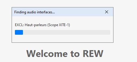

Re: Room EQ Wizard (REW) and Scope ASIO not getting along...
yes, I tried a lot of things, unsuccessfully as reflected by the tone of my post
At some point I just needed to get things done eventhough it is not the best way... :-/
However, one hope is that I may have noticed that it is not actually "stuck forever" , but just takes an infinite amount of time to load (like, it could take an hour... I am testing this right now, yesterday I forgot to close this window and it finally scanned everything... not tested wether it is useable though, not with scope asio anyway, but for using something else)...
Just to help point out that ASIO seems to be a high priority , eventhoguh I understand it may be complex and non generic (I just don't want Scope to end up like noah :-/ , that's like my own nightmare, lol - I posted aftr finding myself looking at soundcards on the market that could be connected to scope where scope is just synths and effects .... but well, I am not in a hurry at all)
PIC BELOW Stuck forever ?
- bug01-REW.JPG (11.4 KiB) Viewed 15568 times
Hi all,
Just to update because, after a long while, REW unfreezes and displays all audio drivers, and asio4all can be selected (scope xite cannot, it crashes the PC immediately). it can take long, like half an hour or more (just let it run and do something else, after a long while it should get out of the "frozen state" shown above).

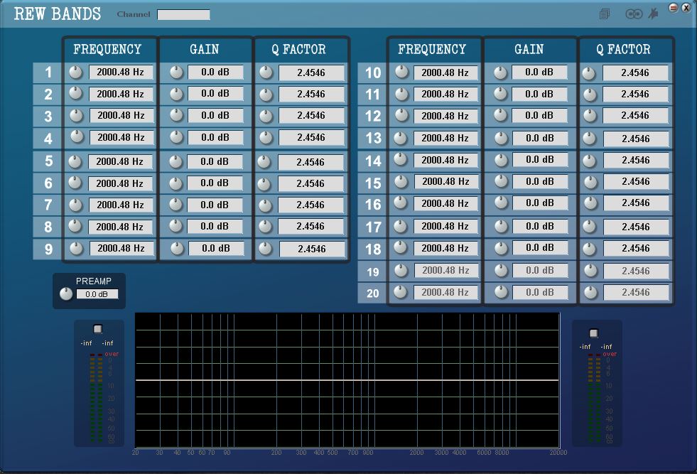

I have posted a "REW EQ for Scope": just a lot of param equalizer where REW values can be input manually (it will need adjustment because it does not have the same result as with APO equalizer). Not perfect but it works.
viewtopic.php?p=369476#p369476
- REWPANEL.JPG (135.42 KiB) Viewed 15491 times
