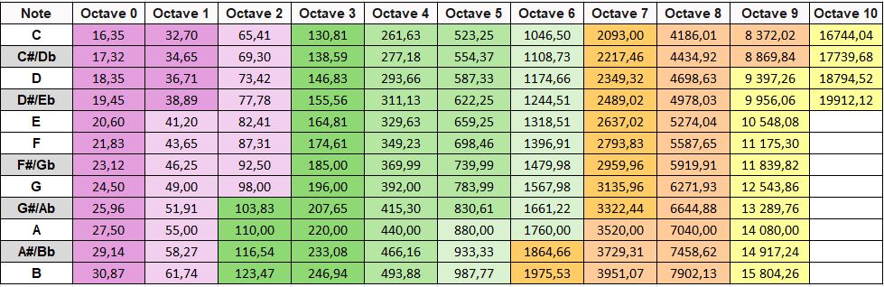

You will find many frequency tables on the internet, and below is the one used inside Rodin, which covers frequencies from 20.60 Hz up to 19 912,12 Hz. (E0 to D#10). 16 bands inside that interact in various ways customizable by he user. The equalizer can be controller with only 3 or 4 potis through its trimmers.
fREQUENCY table.JPG (117.28 KiB) Viewed 68401 times
examples:
41.20 Hz = lowest electric bass note (lower E string) and Sub speakers in sound systems.
82.41 Hz = lowest guitar note (lower E string) and general bass frequency in classical productions (classic rock, reggae , instrument based music)
261.63 Hz = piano middle C
4186.01 Hz = highest piano note
and no, it will not transform a major chord into a minor or augmented one, nor will it remove false notes... It does help making better synth sounds though, that sound clear and present.
it will be highly consistent with 440 hz based music... easy to use, because this is what can really be described as a very musical equalizer..

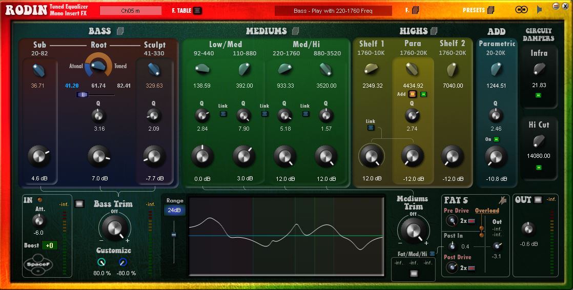

A view of the mono Insert version (Rodin-M.dev)
