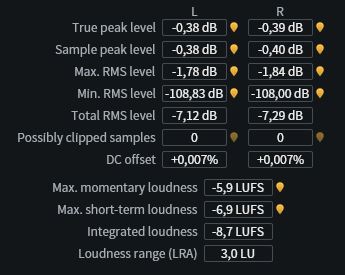

- Just to know, if any of you do mastering, do you use the -1dB peak value or do you choose something else ?
- Myself I aim at -0.40/0.30 dB approx, but it is arbitrary.
- I tried -1dB and found no real difference in level perception (the perceived loudness, the RMS etc, is the same). So I could go this way if useful.
What is the -1dB headroom supposed to do in practice ?
Thanks !
PS: I attach a pic of the numbers I am into (-9 / -8.5 Integrated RMS nowadays - I still have a l ot of difficulty going fully at -9dB and not trying to stay at -8 :-) ).
RMS LEVELS.JPG (22.59 KiB) Viewed 13606 times

What application is the screenshot from?

the screenshot is from Izotope RX audio editor,
as found in menu "/windows/waveform statistics".
