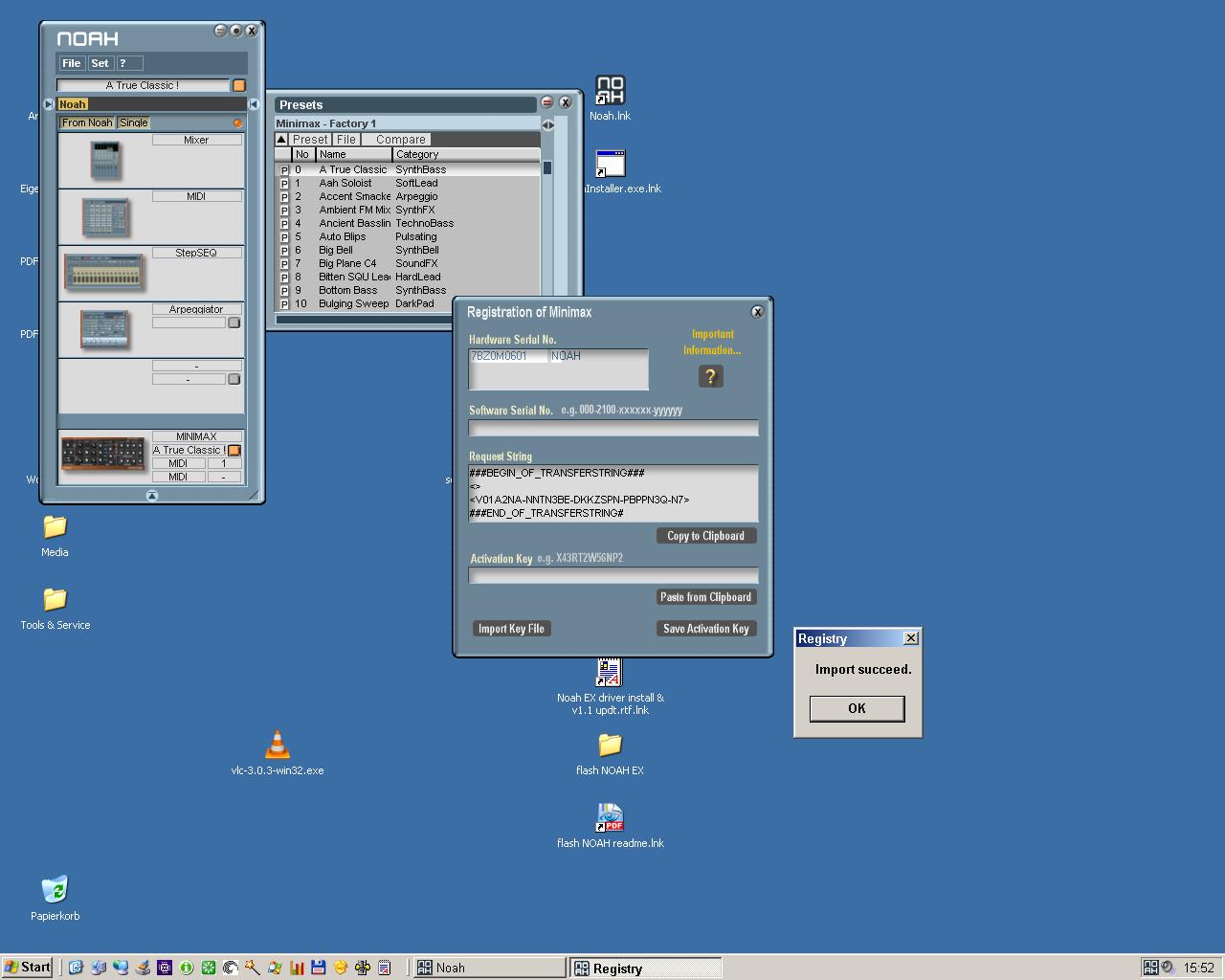

I have a very smiliar problem. I installed Noah V1.1 via WinXP compatibility mode. It runs ver well and I can start all synth-remotes. Only thing is the driver. I get no connection with my Noah EX (USB Mode is Set to Windows) and I have no option to run the USB driver (cwusbaud.inf) in WinXP compatibility mode. How do I get the connection to work?

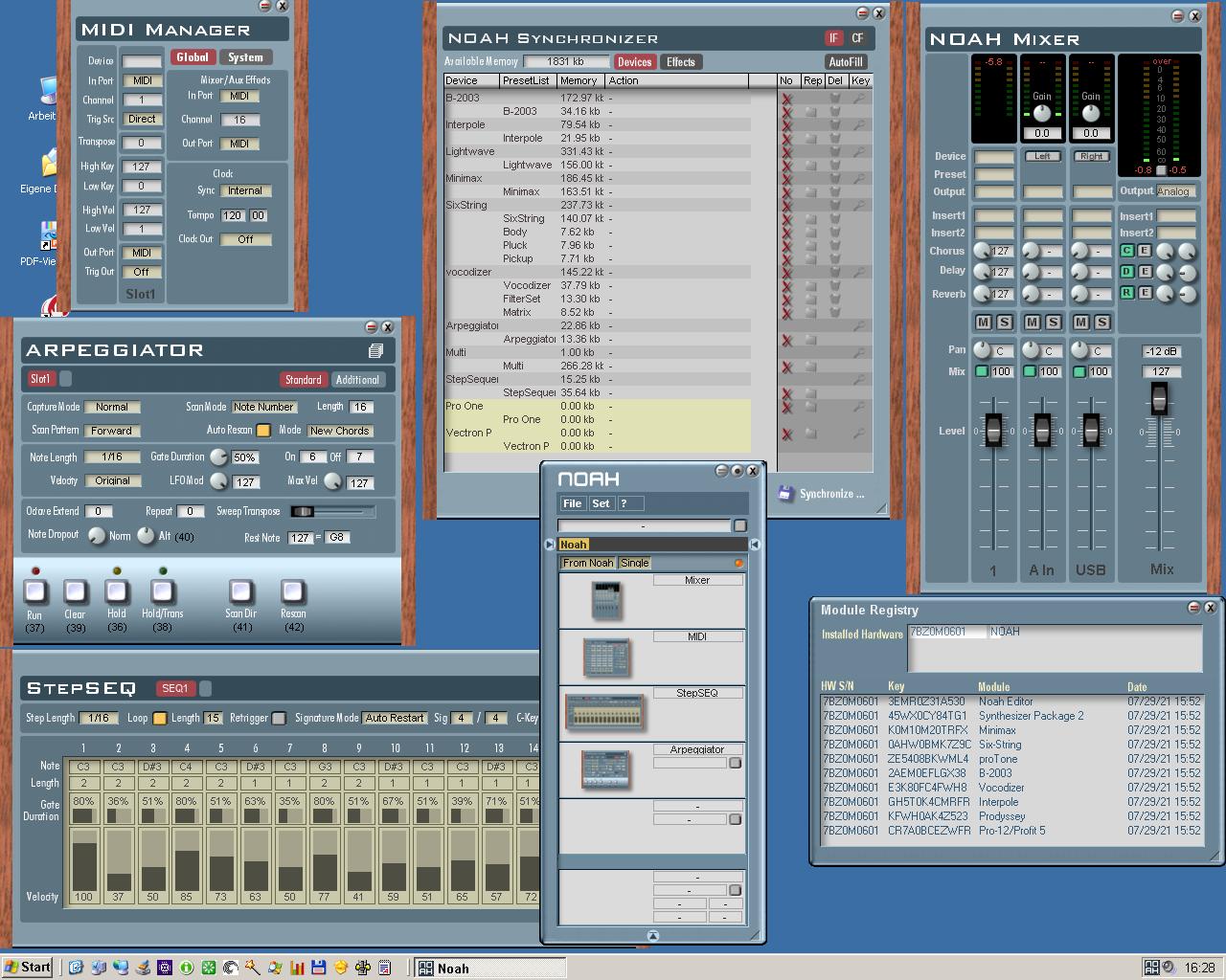

Hi Eisblau !
Seems something went wrong with keyfile import.
ONLY use the flashtool and .dmp files when urgently necessary.
There are no device keys included in these .dmp files.
These 2 files just only install the factory setup or an extended setup already containing formerly optional devices, except Prophet5 which is still optional.
Which to install and use depends on which device activation keys you own.
Upgrading the system software to latest available is the other reason to perform a re-flash.
So, be sure to run the latest system software on your Noah.
Have in mind re-flashing Noah is on your own risk and might render it being a brick when something goes wrong.
OTOH, I myself, I did it sucessfully,- and 3 times. :D
It seems it isn´t necessary to re-flash your Noah ´cause it runs and,- as you say,- works together w/ the Remote Editor Software.
When IRC,- the .allkeys files doesn´t exist anymore and now are .rgy files.
Did you get keys from Sonic Core or did you get keys from previous owner of your Noah ?
The keyfile should match your Noah´s hardware serial number which is printed on the sticker on the backpanel.
I only mention ´cause you say it´s been greyed out in your Noah registry window.
You can import an already complete keyfile,- or device keys one by one when using the .oxe files,- by using copy & paste.
I myself used keys I luckily received from Sonic Core.
AFAIR, the key import didn´t work by drag ´n drop here,- it´s a copy & paste routine instead,- and I too had to experiment a bit how the copy ´n paste routine really works w/ Noah.
It might behave sluggish and might need a repeat until being successful.
I believe it didn´t work w/ mouse right-click and then insert and I had to use the keyboard control "C" and "V" commands and left click (sometimes several times) into the related area before using control V to import the key.
Here is how it should look after successful import,-
Noah EX EditGUIs_Registry.JPG (231.84 KiB) Viewed 14486 times
good luck,-
