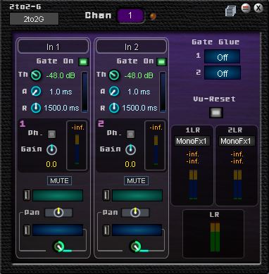

Proudly adding "2to2G" to the pack.
It is like 2to2S but with a home made Gate/Noise Gate.
I first wanted to add a noise Gate, but ended up doing a gate from scratch (only way it would work as wantd).
Then tuned it to sculpt reverb tails, also tested on speech, drums beats...
The GateGlue parameter "glues the gate at the top" i.e. fully open, and closes with a delay, allowing to get rid of short modulations and thus avoiding unwanted "pumping effect". it is a bit like a "Hold" function, but which is relative to the input sound.
More info in the pdf in the zip.
Also all devices were revised (graphics alignment, preset list names...).
Please note: I had to remove the old and reload the updated devices in the Xite project, otherwise some changes were not taken into consideration:
In Mix A/B and 1-Send
---- the 3 mix input levels mid position should be -19.7 dB instead of -24dB
---- Send middle position is now -12dB instead of -24dB (easier to use with mouse, not yet tested with midi CCs).

2to2-G vu meters of the Record Channels were not reflecting actual output (vus were panned even in Mono mode).
Now corrected (connected to the record channel actual outputs).
Updated as a seperate device (2to2-C ) https://spacef-devices.com/free-downloads/
or in the Mono Sends and Return Pack (was updated with that 2to2-C version)
or in the above attachment (1st post)
Sorry for the multiple downloads and delay in correction, as I was using the devices (in Scope, not SDK).
