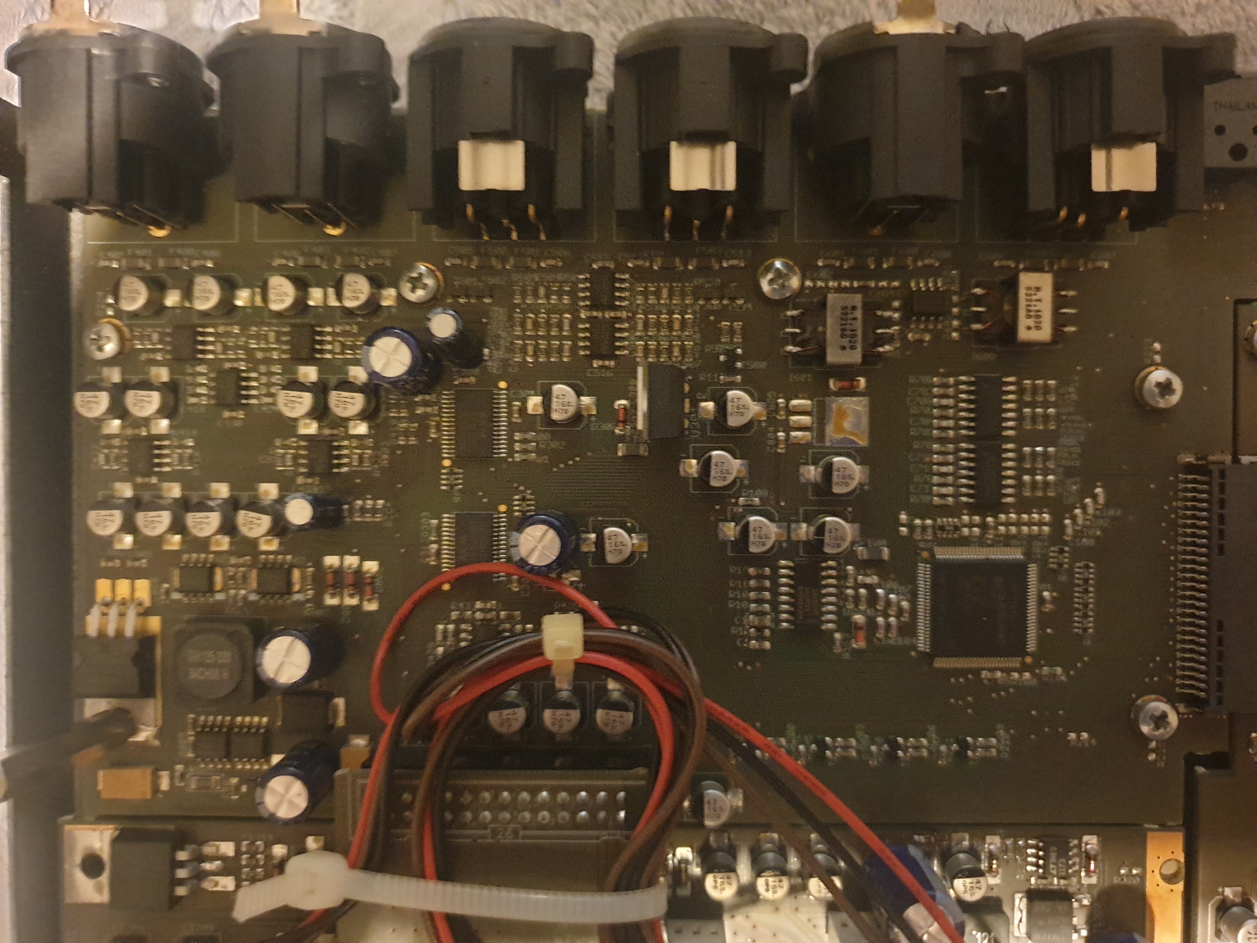

Well I've opened her up. Can't see anything obvious, but I'm only looking on the top board. It's a bit of a faff to look underneath tbh. Also getting the lid back on is proving more difficult than I thought it would.
15 Overview.jpg (1.57 MiB) Viewed 19802 times
14 XLR Outputs Right.jpg (4.6 MiB) Viewed 19802 times
13 XLR Outputs Left.jpg (4.42 MiB) Viewed 19802 times
07 Rear Left (XLR Outputs).jpg (3.93 MiB) Viewed 19802 times

Your problem seems like overload on low frequency. This can be cause of low or garbled feed voltage for output OP amps. First just try another power supply.
Re: Crackling on XITE-1 outputs
I have a spare PSU I bought recently. I'll give it a try.
