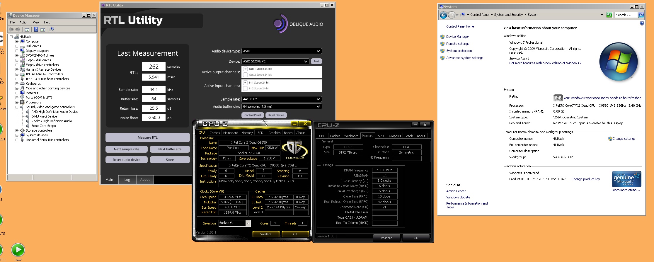

It seems to be possible to get 5.9 ms round trip latency at a buffer of 64 - attached is a JPEG of this - I was hoping it may be possible to up to 96 Khz (thus halving the RTL) but not if it halves the track count.
OBLIQUE RTL LATENCY IN OUT #2.jpg (429.97 KiB) Viewed 16881 times
