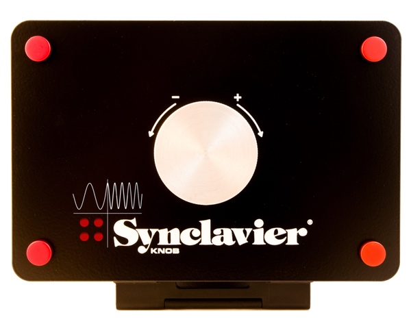

This is probably the world’s most elaborate and expensive pitch wheel ... (according to it‘s maker)
reference: https://www.synthtopia.com/content/2019 ... available/
No need to go that far, though...

Is that thing for real? hehe.... curios stuff...

The Synclavier Knob was in fact for real and a huge thing when they showed it at NAMM together with their Synclavier Go app.
(not sure if they plan another batch, though)
But the knob uses an endless encoder, not a pot. I have it as a DIY project with Arduino, based on an ALPS (!) jog/shuttle ripped from a trashed home video editor. Not started yet...
