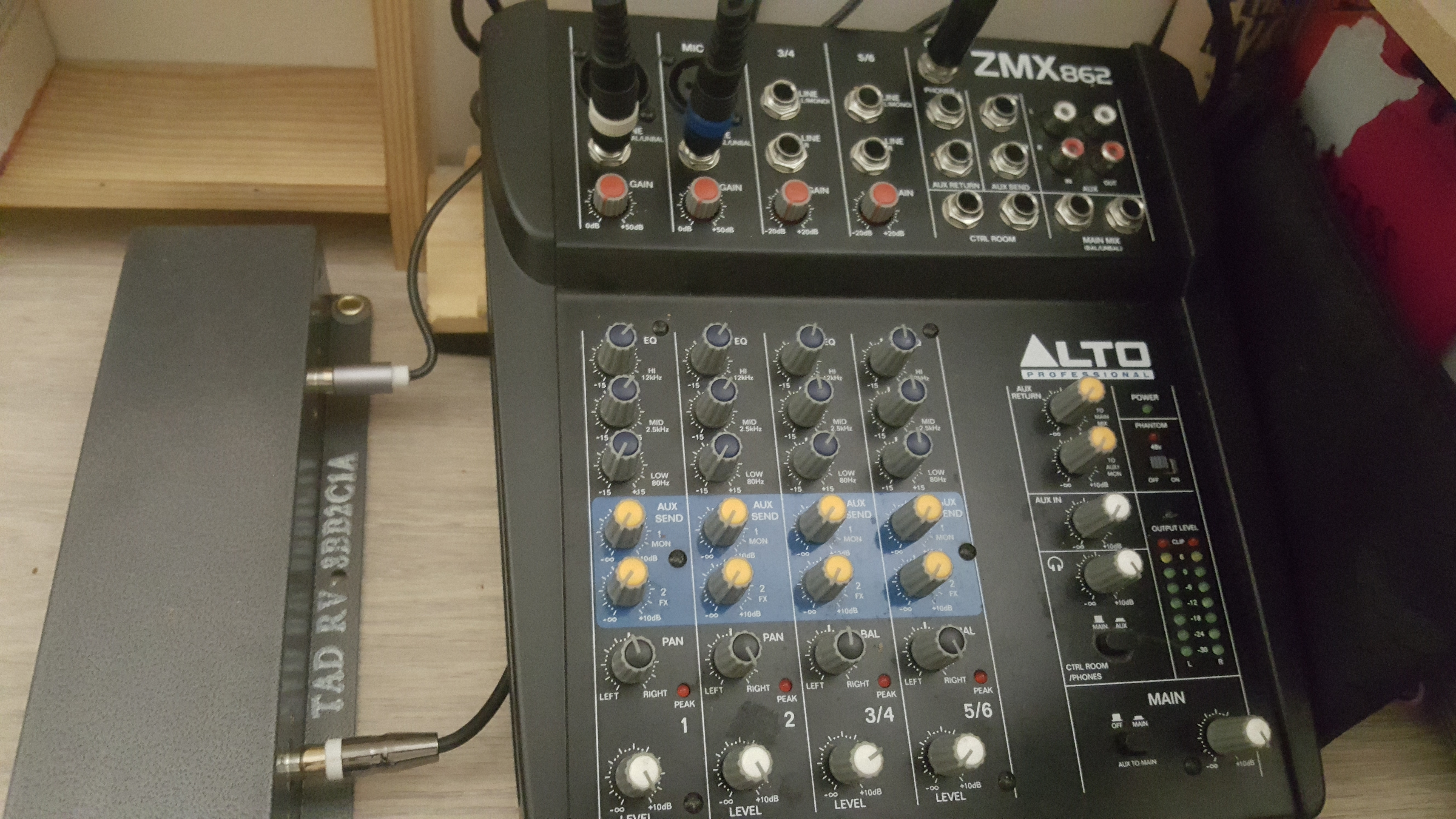

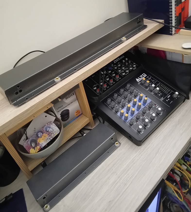

Ok, at last, 1 year later, here is my rig for a Spring reverb on line outputs.
One can use headphone output of Xite to send directly to a spring reverb,
Here are two YT tutorials about that:
https://www.youtube.com/watch?v=CXJdSREWxxY
https://www.youtube.com/watch?v=vIryyi3bp-c&t=1s
but I need the headphones out, to use headphones, so I needed to use Line I/Os to save the headphones out.
Problem: headphone amplifiers are not made to be plugged on Line outs (they just extend the headphones output). So it is useless if one needs to use Line i/os (except more expensive models probably).
- I got a second hand mixtable (alto ZMX862) with most outputs @ 120 ohms, including headphone output. So it is like a headphone amplifier with extra functions. I can feed it with line level signals (you can't do that with headphone amplifiers).
- The Spring is BB type ( 150/190 Ohms input /// 2575 ohm output)
- The Spring goes to a HiZ input of Xite with RCA to TS cable.
cost: 40 € second hand mixtable + 30 € spring (NEW) + 18.50 DHL + 9.99 2*RCA to TS" cables = 98,49 €
You could add another tank and use PAN to route signals to one or the other or both, in dual mono or stereo.
that would be around 150 € for a dual spring setup.
One could add a DI box to convert the HiZ from the Spring into a Line signal (a dual box for stereo).
Voilà, problem solved, sounds better than IRs ;-) Will allow to turn many Scope Delays into proper "EchoVerb" units.
Made me think that of SOnic Core ever does another card, it would be incredible to have spring i/os to use them directly ;-). (lol, that would be unique)

spacef
Posts: 3361
Re: will this spring reverb work as an aux (impedance/RCA)
Post by spacef »
Here are some pics of my final setup. I also made devices for them fo Scope/Xite, that you can find
here viewtopic.php?p=356852#p356852
or there https://spacef-devices.com/free-downloads/
They are Send/Returns tailored for mono effects. Fully tested with the pictured setup ;-)
Sounds really great like that...
