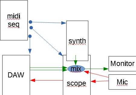

Here's a picture of my latest approach.
The DAW is just for voice tracks.
At the end, it should also record the final mix.
Is this a common way to do it ?

Re: singer setup ?
Is the monitor headphones or speakers ? Example of a loop back for mixdown here :-
https://www.scopeusers.com/ScopeRise/is ... cubase.htm
Re: singer setup ?
There are lots of ways to do what you want in Scope. Put your recording engineer hat on and figure out what works best for you. Every single user here will probably give you a different answer. (different Scope hardware, DAWS and different external gear)
I like the STM-2448 as a default. Lots of routing options and low DSP.
Re: singer setup ?
the most advanced setup would be to use a switch, to switch from microphone to daw inputs.
For the recording, the most convenient is to use a mixer with a "rec channel" where routing is made internally , or use an aux or bus to send signals to record to daw. After recording, you use the switch to change the source of the channel and keep the effects that you used during recording but without mixing them (such as aux reverb/delay), or you simply mix in the daw. in general effect for the recording session are just there as aux for monitoring and singer comfort, so they are not recorded but fine-tuned later. you could also record them on another track(s) than the dry voice.
I think I made such switches or "y crossfader" for free , it should be somewhere in the device section of this forum.
I hope it helps.
I hope it helps.
