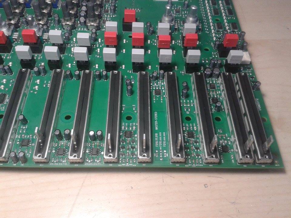

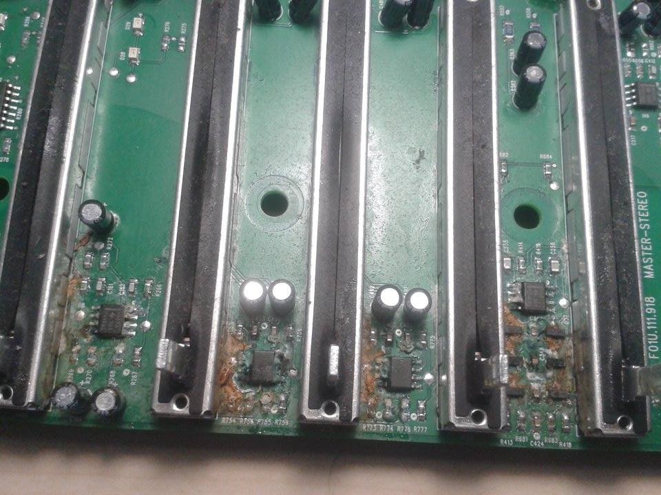

BTW: You can see how my friend works in these pictures. It is a repair of a watered mixer.
