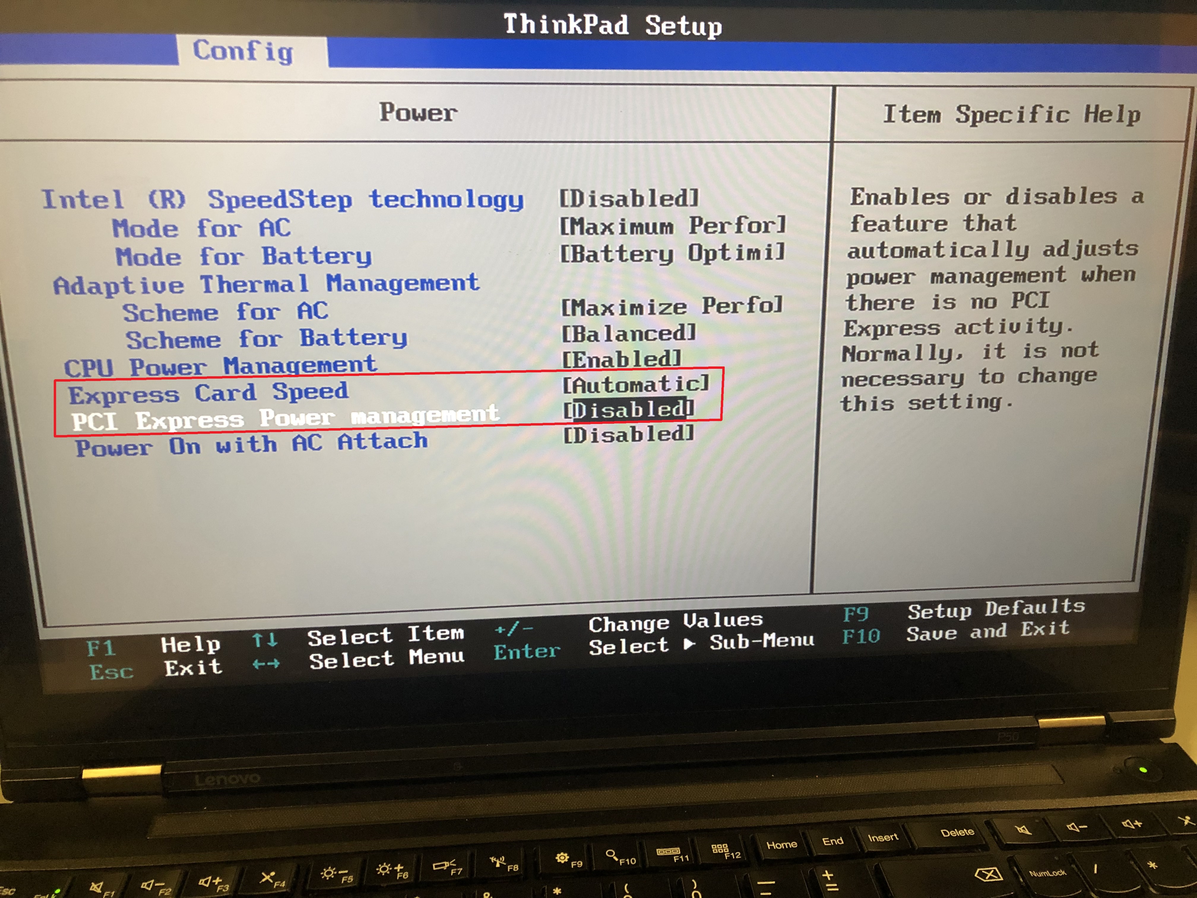

Xite Knight v2.0
Posts: 106
Joined: Thu Nov 19, 2015 9:10 am
Location: The Kingdom of Denmark, including The Faroe Islands and Greenland
Re: Scope 7
Post by Xite Knight v2.0 »
Liquid EDGE wrote: Mon Dec 13, 2021 3:26 am Nightmare…
What is odd is that when I was sorting stuff out.
I was about to give up on Mattomat as every time I loaded it it would blue screen of death. But for some reason once I had successfully opened convolveq and other das plug ins and the Analyzer, I decided to give mattomatt another go, then magically worked…(again) blind trial and error luck. 🤷‍♂️ (Well not blind, a def pattern was emerging) as if a plug in pokes about with something that Mattomat also pokes at) and in my case it all got reset if I dared open c350 or Masteriteq.
Could just be a coincidence, I’m not a programmer, I’m a user. 😊 but the same patterns were happening, it was not random!
Load c350 everything crumbled… go to Mattomat first, crash….
Re install all files, install c350L & masteritL…
Successfully load up c350L, masteritL, convolveq, Analyzer, and then go to mattomat and it then successfully opened…
NOT ANYMORE :D :lol: :D :lol:
IT WORKS!!!!!
I was just about to give up, but based on the rare PCI capacity limit reached message, I started to monkey around in the bios. I changed the two parameters inside the red box below:
  • Express card speed from 'Generation 1' back to 'Automatic' (default)
  • PCI Express Power management from 'Enabled' (default) to 'Disabled'
So one of those two should be the culprit, in case anyone gets the same problem in the future.
There's no way that I'm going to test which one would get me back in trouble again :D
My C-drive is now image backed up - case closed and back to actually using Scope :lol:
Thanks to Liquid EDGE for making me keep on trying!
Posts: 7698
Re: Scope 7
Gen1 is very limited in speed, and the latter allows clocking states for the control chip to reduce power. So yep, can see how that made a difference.
