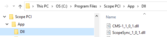

Did you use the Windows Installer to install CMS-1? Theoretically that should walk you through all of the steps to choose the right directories to install stuff, including dependencies like the C++ redistributable. There is a Zip file version, but it's definitely more complicated to install manually.
32-bit and 64-bit should both work fine, also for the VST plugin versions both in VST2 and VST3. I know a lot has changed in VST3 support in the last couple of years though, so let me know if anything has stopped working.
w_ellis
Posts: 572
Location: Berlin, Germany
Re: CMS-1
Post by w_ellis »
By the error message, I would suggest that the DLL file didn't end up in the right place in the Scope directory. If you have Scope installed in a non-standard place, you need to tell the installer, so it knows where to put it.

Re: CMS-1
Post by w_ellis »
When I run the installer on this Windows laptop, this is what ends up in my Scope PCI folder:

Try running the cms installer again and pay close attention to the directories tab. Do you see that dll file in your scope xite/app/dll folder?
Liquid EDGE
Posts: 1205
Location: Brighton England
Re: CMS-1
Post by Liquid EDGE »
Yeah it’s there.. 🤷‍♂️
Installed again as well.
w_ellis
Posts: 572
Re: CMS-1
Post by w_ellis »
Strange! I assume you've tried the obvious things, like restarting scope and/or your pc?
Other things that could be a problem would be if the c++ redistributable didn't install properly or if you have a firewall that is blocking the dll.

Liquid EDGE
Posts: 1205
Re: CMS-1
Right, what I’m finding is that only scopesync 1.0.1 .dll & (vst) is the only scope sync working on my XP32bit set up, anything else does not get found. Generates a “can’t find blah blah dsp” and the only scopesync related VST that shows up in cubase is scopesync1.0.1
What was all this stuff written on?
I know xp is a dinasour of an OS so that’s what I’m putting it down to…. So I’m guessing that the CMS-1 files want/tweaked/use scopesync AFTER 1.0.1…. 🤷‍♂️ (I’m sure I had a working CMS-1 on xp, but I’m sure it was the first/very early version of it, not sure, can’t remember fully)
Total assumption here…
