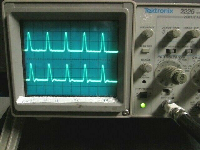

In Samplitude, there is a Oscilloskope, which is not really usefull.
Maybe a phase oszilloskop (vektorscope) is what you need ? It is also in Sampltude..
On gary's hardware solution, you'd get that paperclip with additional scale information for free, which might be also a good deal. :D

I'm also all about the hardware, I have an old-fashioned phosphor screen oscilloscope and vector-scope. For more portable operations I have a Hantek 6022BE, which is inexpensive and gets the job done.

nebelfuerst wrote: Sat Dec 11, 2021 10:51 am On gary's hardware solution, you'd get that paperclip with additional scale information for free, which might be also a good deal. :D
I immediately saw that ! hardware is always superior. it's probably the reason why noone has been able to modelize it for computers.

Hardware oscilloscopes and waveform meters are often meant to work up to the Mhz range (if not higher). GaryB is lucky to have found an old unit, I have seen them occasionally on Craigslist and they still want too much for an impulse purchase ($1k+). Wonder if that's changed, I haven't looked in years...Virtins is meant to replicate those workflows, and the versions that work with the soundcard are inexpensive but I wonder how the workflow is.

Re: Oscilloscope for ASIO windows ?
that was just a picture, but you can find a real one for $200.
