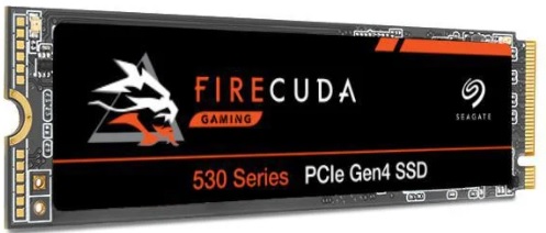

Im wondering if I can drop a couple of these to replace the M2 Samsung SSD in my Gigabyte Z390 setup:
Firecuda SSD
Firecuda SSD
Seagate 1TB SSD, FireCuda 530, M.2 2280 NVMe 1.4 PCIe Gen4, Read up to 7,300MB/s, Write up to 6,000MB/s, Random R/W up to 800K/1,000K IOPS, 1.8M Hours MTBF, 1275TBW :o
Re: Firecuda
You won’t get the Gen 4 speeds since the Z390 is Gen 3 x 4.
I just stuck a Gen 3 x 4 in a Gen 4 slot as I just didn’t see any advantages from Gen 3 to Gen 4.
The specs are “better” but in our apps you might see slightly faster loads but that’s about it.
I know guys who bought Intel’s because they beat the pants off of everyone with random read and small seq files, which we use.
And even then it just doesn’t show any real difference because of ASIO limitations.
The best things we can do is max out IPC and lower our latency.
I don’t even see a difference from SSDs except I can load samples from Omnisphere a little quicker.
But for the OS + Apps NVMe M.2’s if connected to primary slot (direct to CPU) is a good way to keep things snappy…
