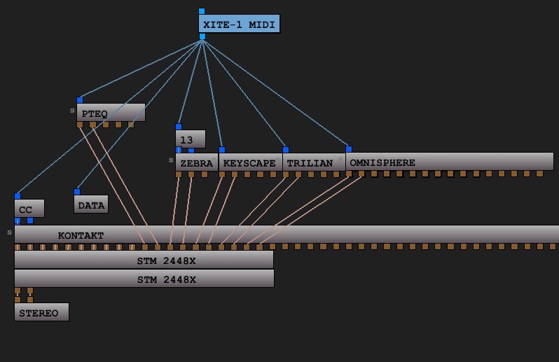

Bidule has a log file, which you can post at the forum where the devs will reply with the problem and fixes.15 years with 100% stability for me, and personal fixes for Scope before they updated to 7.
Best forum for custom layouts as members compete with each other to help out lazy guys like me.
I even have SR Pro call up GUIs of VSTs.
Bidule + Scope are the best live performance tools on the market, period..
- C73F57F0-1F9D-40DD-9653-8E606FC6827D.jpeg (75.74 KiB) Viewed 4519 times
