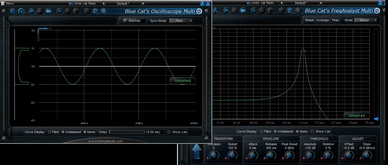

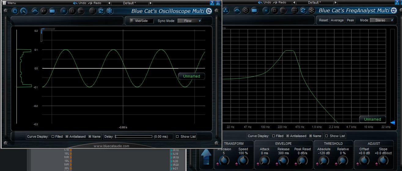

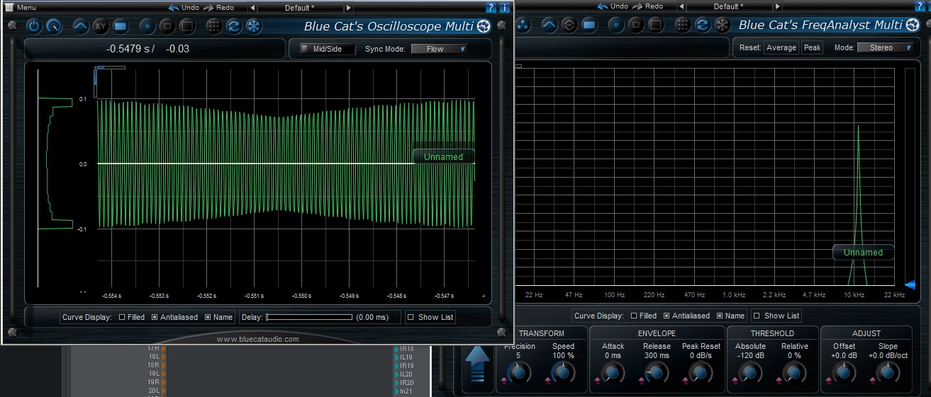

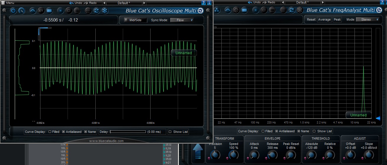

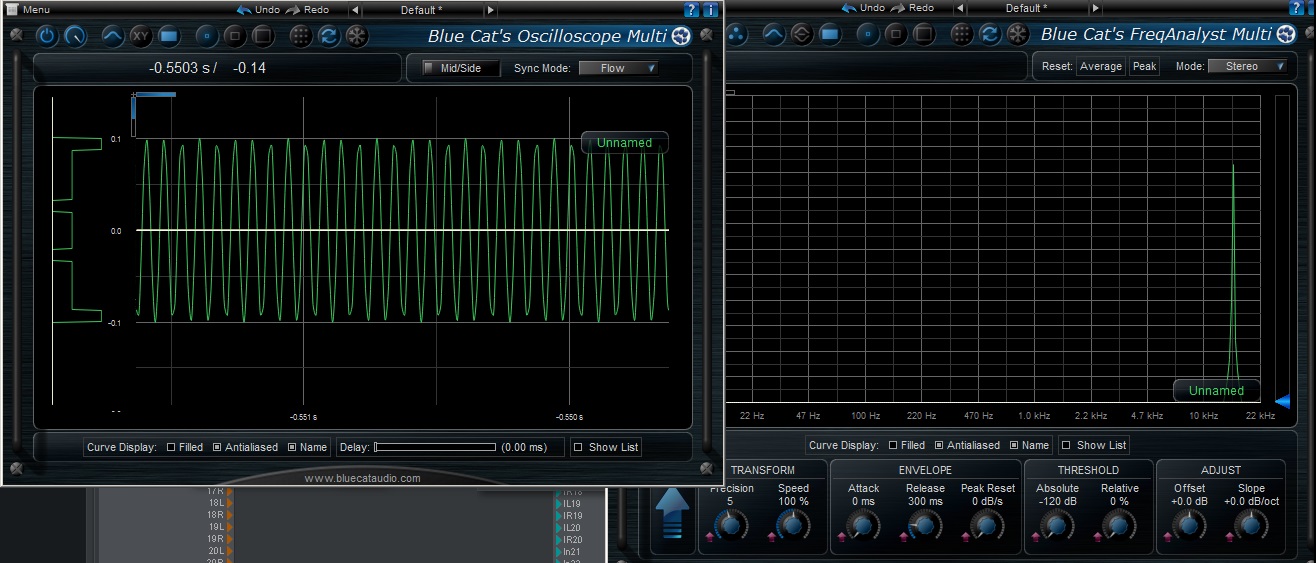

Here's some pics that show you what I mean:
I tried it at 96kHz and it explains it's a samplerate problem.
300 Hz - 41.kHz SR.jpg (204.17 KiB) Viewed 6849 times
Smoother response at 96kHz
15kHz - 96kHz SR.jpg (230.87 KiB) Viewed 6849 times
15kHz - 41.kHz SR.jpg (228.49 KiB) Viewed 6849 times
11kHz - 41.kHz SR.jpg (239.86 KiB) Viewed 6849 times
1kHz - 41.kHz SR.jpg (194.42 KiB) Viewed 6849 times

Yes I've tried analysing it with GOST and it shows sine wave amplitude modulation clearly at high frequencies unless sidebands are creating that. I'm not sure, maybe you experts could say.

Yes, looking at you picture this is what is happening.
At the very foundation of digital audio is the Nyquist theorem. It states that "a sinuisoidal function in time or distance can be regenerated with no loss of information as long as it is sampled at a frequency greater than or equal to twice per cycle".
If you just glance over it, it might seems intuitive and somewhat obvious. A waveform at 20kHz the frequency between the valleys and peaks in the signal will be 40kHz...makes sense.
However when you think about it, it seems wrong. First of all it would be a triangle wave not a sine, as as you know a triangle contains harmonics, and there should be "no loss of information", so we should get a perfect reproduction, ie a perfect sine. And if it is not exactly half the frequency the waveform will be very jagged, like you see in your pictures.
But the important part is that sound is a "sinuisoidal function". When the signal goes thru the DAC a sinc function will be applied, interpolating between the values in a sinuisoidal fashion.
Some oscilloscopes and editors will display a visual representation including the application of a sinc function, but most wont and instead draw straight lines between each sample.
