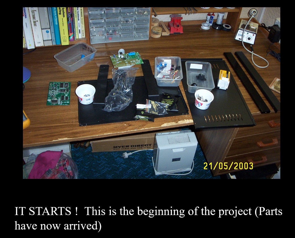

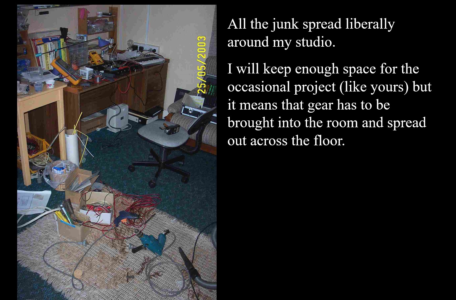

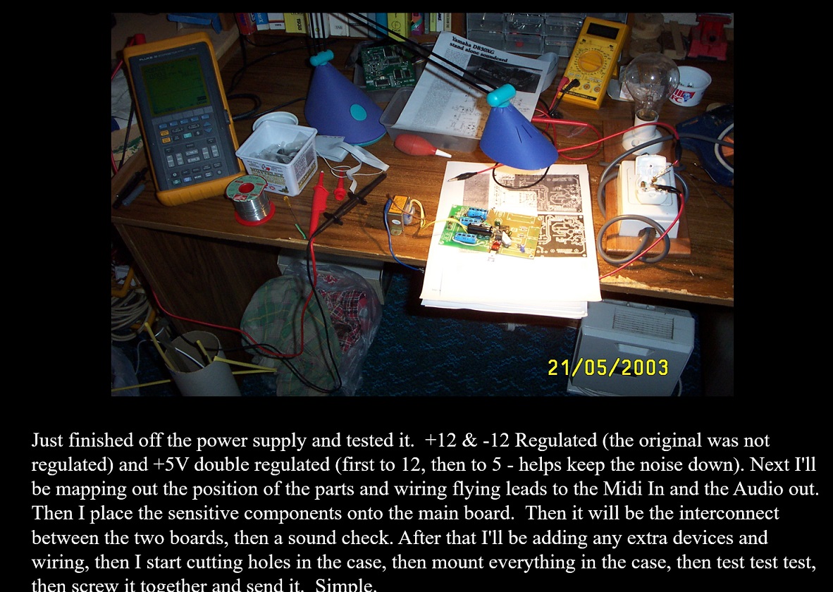

Well I had a mate do it - he's kind of a Wiz with electronics so did it without any previous experience on music gear or MIDI other than hi-fi maybe. So I sent him the card and a 1 octave MIDI keyboard to test it - project pics follow :
DB50XG #1
DB50XG #1
DB50XG #1.jpg (314.59 KiB) Viewed 4160 times

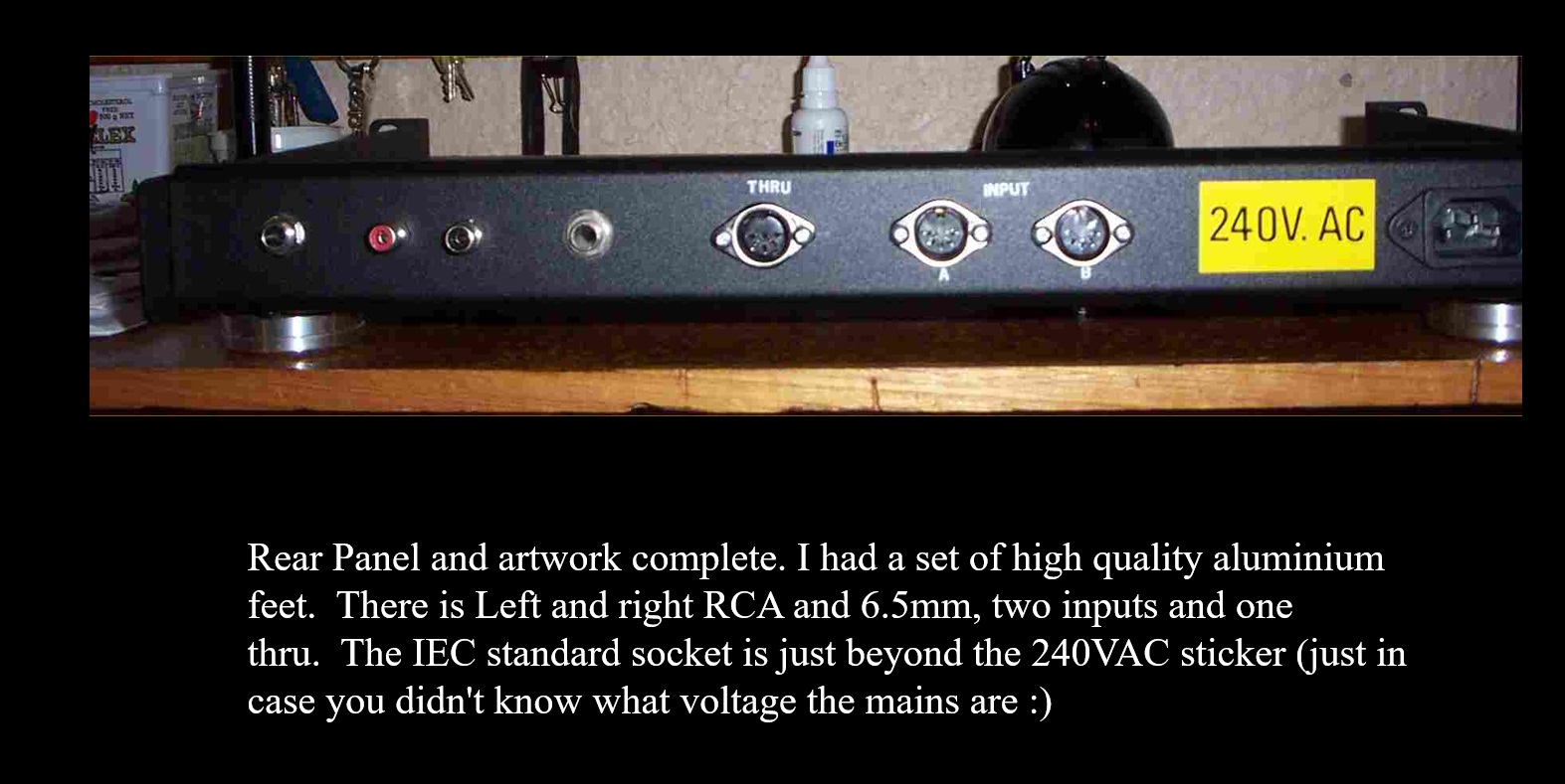

Posts: 5052
Re: First sound card.
I think in this pic you can see an article he used for the design.
DB50GX #2
DB50GX #2
DB50XG #2.jpg (329.18 KiB) Viewed 4159 times

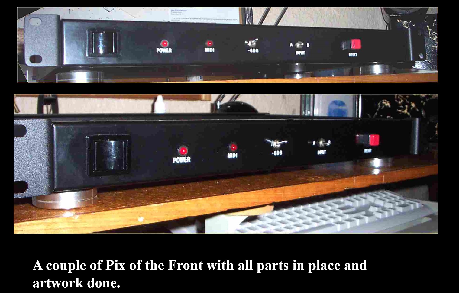

Posts: 5052
DB50GX #3
DB50GX #3
DB50XG #3.jpg (235.71 KiB) Viewed 4158 times

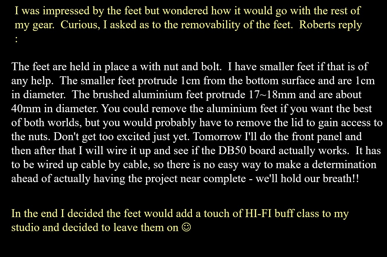

Posts: 5052
DB50GX #4
DB50GX #4
DB50XG #4.jpg (389.37 KiB) Viewed 4158 times
Posts: 5052
DB50GX #5
DB50GX #5
DB50XG #5.jpg (293.63 KiB) Viewed 4157 times
Posts: 5052
DB50GX #6
DB50GX #6
DB50XG #6.jpg (354.4 KiB) Viewed 4157 times
