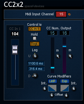

Posts: 7778
Re: 10 bit midi in scope?
We have quite a few options for midi filtering in Scope.
