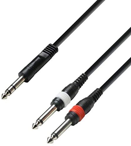

For now, i just have this cable, 2 x mono output to 1 x stereo input.
