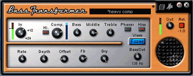

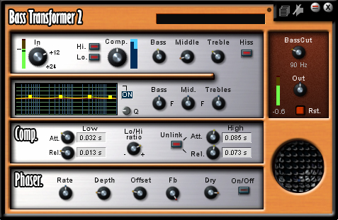

The BassT devices are effects which includes 2 compressors placed after a frequency crossfader.
it allows to compress differently the lower and higher frequencies. The compressor Ratio is "relative to the other frequency (if bass comp ratio is high, then hi comp is low, and vice versa). It pretty easy to find the right comp. The Input and General ratio at the top left of the device is the start point o the compression. ON the bass T2 you can disengage compression from either hi or low. on the Bass T1 , you can disengage only from the high frequencies.
It does not include any amp/cabinet simulation but 2 equalizer stages (1 is classic 4 band curve, and the other is fixed frequencies)
You could add amp sims as vsti, after recording, but I never found one that is really "that" useful in comparison to eqs.
I have read the threads about bass amping + scope but I confess the best sound I get for recording is "dry" most of the time. That's how you get the cleanest and most full sound that is easy to eq and manipulate after recording. I also have a Mooer Radar (guitar pedal) which is pretty cool and sometimes helpful for bass. I would advise the mooer radar to anyone looking for inexpensive speaker simulation for bass and guitar. I do not remember if I used the mooer on bass for my most recent bass recording. What they do nowadays in the amp sim department is pretty amazing compared to 10 years ago. I never use "guitar rig" anymore it is completly outdated (and was never good for bass, that always sounded muddy). I still used it sometimes for extra amp sim (even after the mooer, as an extra "colorization" effect).

T1 is the same as T2 but with a button to change "pages". The T2 displays everything at once.

See below for BAss T1

Re: Bass amps / plug ins designed for bass guitar black box 2
Just realized the Bass T1 was freeware and was avalaible on planetZ downloads rather than on the BB2 pack.
so I can attach it here.
With the T2 you can disable comp on both Hi and/or Low frquencies, I thinks that's the main difference in addition to the display (probably some fine tuning here and there too).
