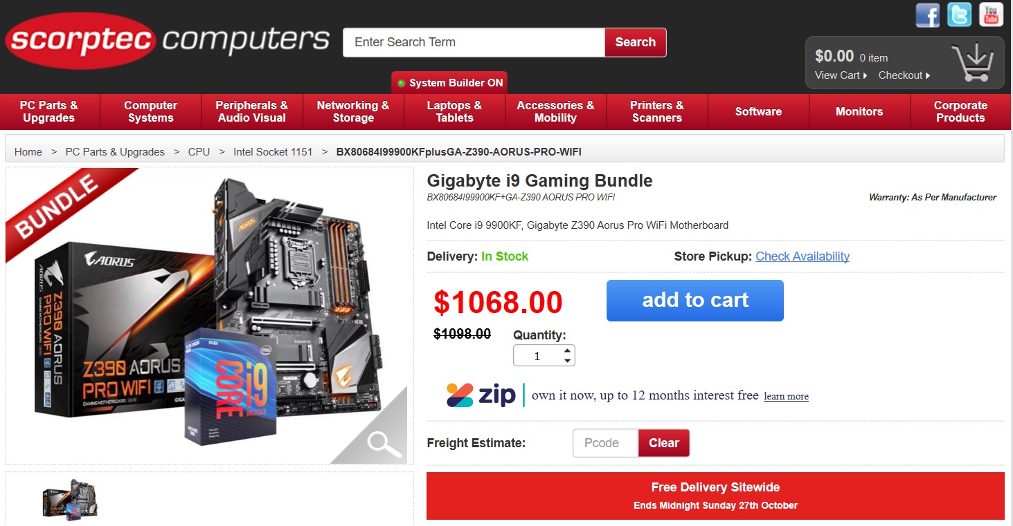

So the below system should work with XITE-1D ?
https://www.scorptec.com.au/bundle/CPU/ ... S-PRO-WIFI
i9-9900KF Gigabyte Z390
It should work, i don't see why it would'nt. I'm judging by Pygmy Audio Farms's specs in his post so i can't say with 100% certainty it will work. All we can do is look at someone else's working specs and copy them as much as possible and thats often the safe way. v7 of SCOPE eliminated a lot of issues with latest computers and SCOPE so more compatibility success stories have been posted and it's less risky now.
Let us know how it goes with that Weapon-Of-Mass-Destruction DoomsDay Device :) . That i9 8-core with XITE-1D is extremely powerfull and i'm sure it will be a dream machine for you for many many years.
Yup, should do as it's the same stuff on that board. Had no problems. Working out what bios settings to turn off is a conundrum which still has me scratching my head, though nothing I've disabled so far has compromised performance. The Xite card sits nicely in the top x1 slot next to the processor, after much reading I reasoned this slot isn't throttled/shared with an m2 ssd
