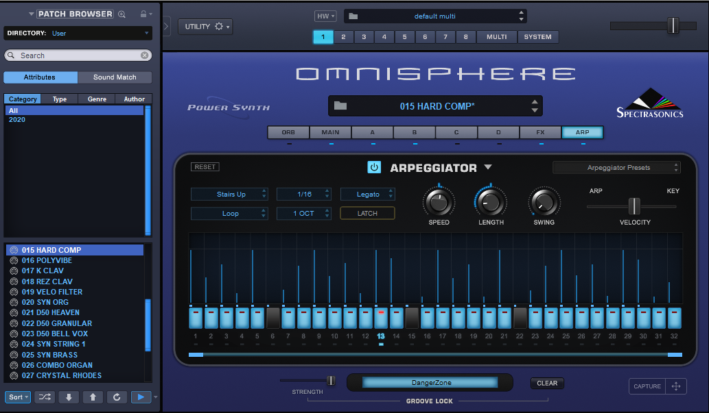

Here’s what I got after dragging the MIDI File into Omnisphere.
My issue is I’m not sure if the arp they’re using is written as a note on only or a pattern re triggered with a new note every 4 beats, etc.
Totally clueless.

doesn't look quite right as far as the intervals are concerned. maybe if it sounds right then use it?
Also in the DAW it's written as continuous notes so not sure if that translated correctly.
Can you record it and post?
