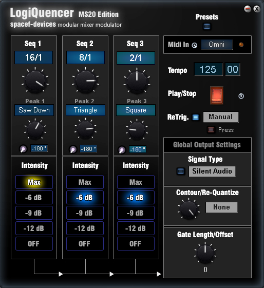

It's available on S|C ftp, in the spacef free plugins sub-folder.
It works with anything that accept audio modulation and audio gate triggers.
It was made for the Korg MS20-mini but works exactly the same with Ocean Swift Synthesis OS20.
It works also as a modulator for filters (for Modular Mixer v1 and v2) , modular patches and so on....
Find it here : https://spacef-devices.com/DOWNLOADS/Logiquencer.zip

Logiquencer freeware
- LOGIQUENCER.jpg (137.78 KiB) Viewed 27015 times

Hi Jimmy, thanks
To work with CV it needs a audio to CV converters. I know that expert sleepers does 1 (the ES3 - adat to CV) for 8 CV.
Are there other ones ?
You don't need an audio to CV converter if the sound card outputs are "DC Coupled" (I think only RME does this), but I think there will also be latency.

iirc, it is MOTU that has DC-coupled outs (on most of their interfaces). Some RME interfaces have their headphone outs DC-coupled. There is a list somewhere on the expertsleepers website.spacef wrote:You don't need an audio to CV converter if the sound card outputs are "DC Coupled" (I think only RME does this), but I think there will also be latency.

My ADA8200s are modded by Black Lion Audio and have 16 x DC Coupled XLRs.

Ok, now I'd like to ask, ReTrig Manual works, keyboard does not work. (xite-1)
...pci not used yet. did you notice that already?
ps.:
offset 32 works fine to convert bi2uni with -12db for fullrange control inside scope cv-toys

I have just checked and it should work fine. I will check again tomorrow for exact version. Thanks for your patience.
NB : For CV are you talink about bipolar modulator ?
For info, the range of a 3 octave CV Signal (like the one you get by using Expert Sleepers ADAT to CV) is approx the range of the scope signal divided by 3 (approximately). To control the pitch of an oscillator over more than 3 octaves, then you would need to add several CV inputs and make them very precise (for ex, the 1st CV controls octave 0 to 3, and other CV controls octave 4 to 6 - then the work is to find the right method to add both signal so it stays in tune, which means that the second CV must be equal to 0 over the whole range of the first CV. This must be done "after" the Adat to CV conversion because it manages only 3 octaves "no matter what".
A total loss of time for scope though, people can buy a keystep keyboard second hand, it has a CV output and can play the full keyboard range.
For unipolar/bipolar, I confess I do not know what you are talking about

Here is a download for you
I just checked and it works fine with Keyboard retriggering. It is the latest version that I Have
