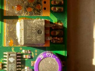

Thank you for your response and offer. I meanwhile bought a new RME card. I practically wrote off Pulsar. It is not worth sending it by mail and paying for repairs. Only if you can tell me (send a picture) where exactly that transistor is to tell my friend to change it. If it works I might be able to install it on my backup computer.

The part of the voltage regulator is the black quare part with I*R 3103S labeled on it.. on my scope card, so I suppose pulser2 is the same.
You can buy them from aliexpress and you need some soldering skills to remove it.
For a pulsar2 the price in germany is in the order of 200 Euros, so there is a natural limit for repairs.

The only thing that looks like a transistor to me is this. The specifications say that it is a "voltage regulator".
nebelfuerst
Posts: 606
Re: A communication error with Pulsar2 (brd 0) has occured.
Post by nebelfuerst »
Yes. You're right, this is the one for a P2.
I had a look at my cards, so here are the mosfet for P2, Luna and scope.
For P2, the datasheet can be found here.
https://www.digchip.com/datasheets/part ... AU-pdf.php
Looks like they used different schematics for voltage regulation.
The easiest way is to buy exactly the same part. otherwise you'd have to do some datasheet research..

It's not that I don't want to help you, It's that I question your ability to do the repair if you don't even know how to identify a transistor. It's really easy to do damage to the card & you may do more damage than good. All the parts are labeled clearly on top of each component, the power mosfet that I mentioned above is the one that is soldered directly to the large metal plane which will take a lot of heat & flux to remove. The others have posted the pic of it above. Also, the boards need to be cleaned afterwards, preferably in an ultrasonic, so if you leave all that flux behind, can do more damage than good. You may be better off selling it for parts as is on ebay because if you damage the card it will be worth a whopping zero.
