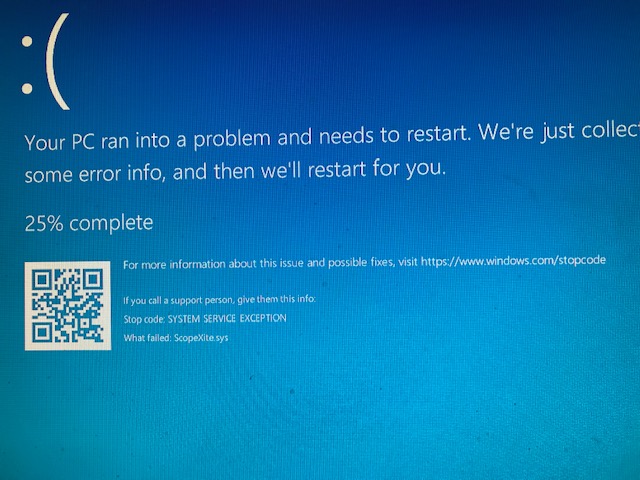

After installing Reason 10.3 it crashes accessing Scope on startup. Interested to see if mine is an isolated case (any other Reason users here ?)
Here is the ticket I raised with Propellerheads :
Propellerhead Ticket
Propellerhead Ticket 29157.jpg (138.69 KiB) Viewed 5638 times
ScopeXite crash
ScopeXite crash
ScopeXite.sys Error.jpg (118.09 KiB) Viewed 5637 times

Nope didn't work - I thought it did initially, as Reason started - but as soon as I selected 'Scope XITE in the Reason Audio setup, crashed. So I will wait for the PHeads.

I would guess Propheads have modified the initialisation of audio ports as part of their audio engine rework (which has taken a few months). So if you disable Scope in device manager prior to starting Reason then select the MOBO driver, then close Reason - re-enable Scope in device manager, then restart Reason it will start OK because it remembered the last active (non Scope) audio driver. So then, if you go to Reason then try to select Scope as its audio port, then crash occurs. So then - after reboot from crash - you have to disable Scope in device manager - restart Reason and select Mobo sound. From there its OK again (but no Scope).
