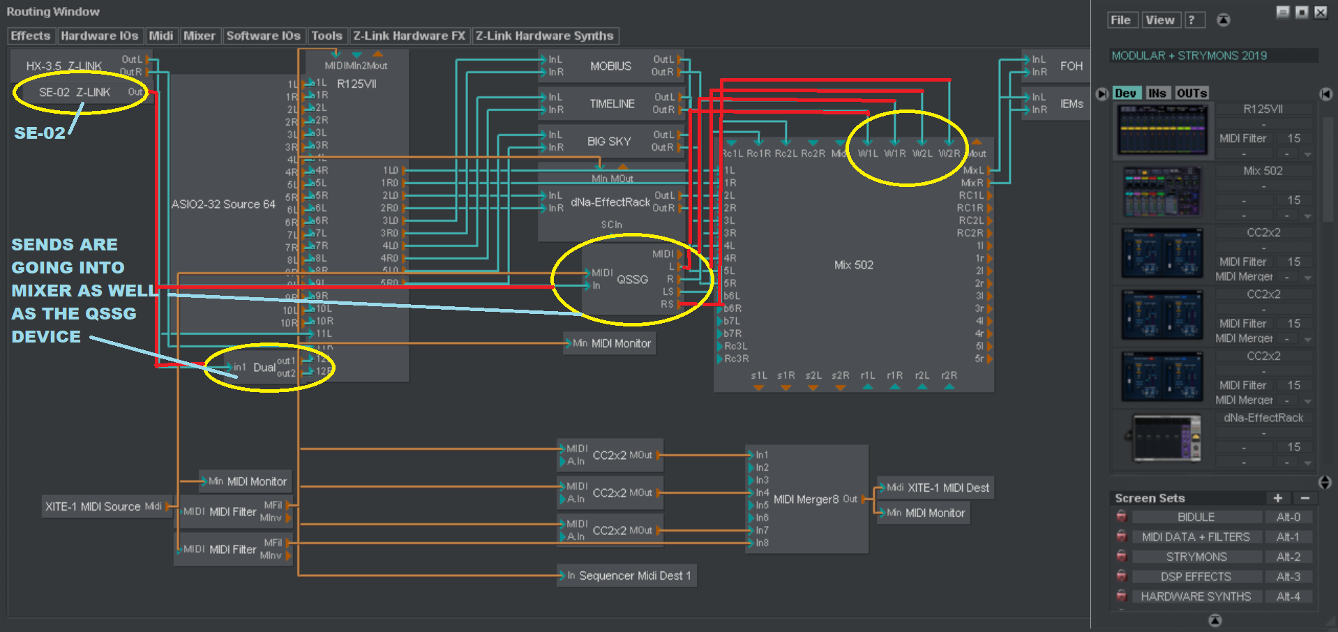

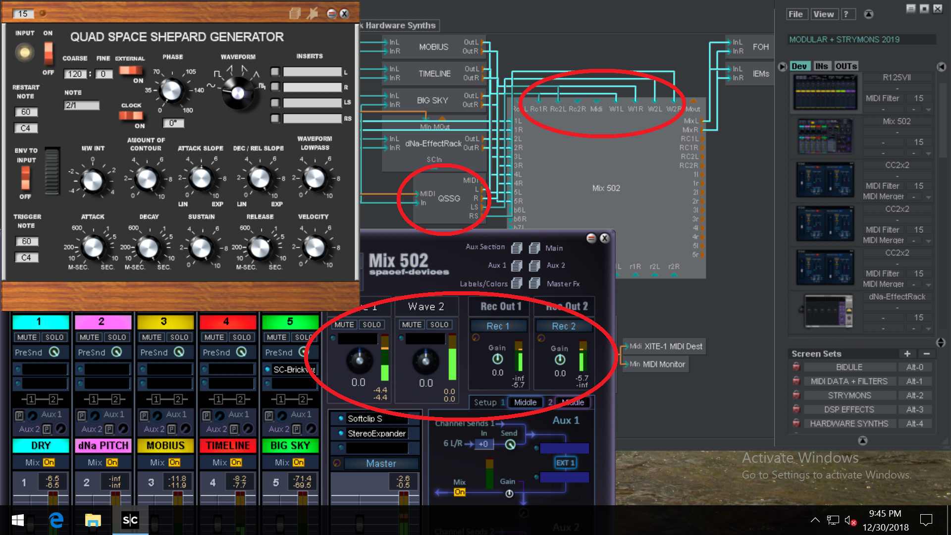

Well I got a new Toy for Monophonic Analog Leads.
I’m taking SE-02 outputs into the R125 vrs. 2 where it gets a Strymon Timeline Bucket Brigade Delay, but also goes into the QSSG where the magic happens.
2/1 speed rate makes the effect slow, Envelope is also useful for blended the QSSG Effect with the SE-02 + Strymon.
I don’t know the scientific names or anything but let’s say there’s lots of motion making it a pleasure to hold a note where the Synths Cutoff/filter has a little attack also, so the brightening up of the filter coincides with the QSSG and it’s fascinating.
