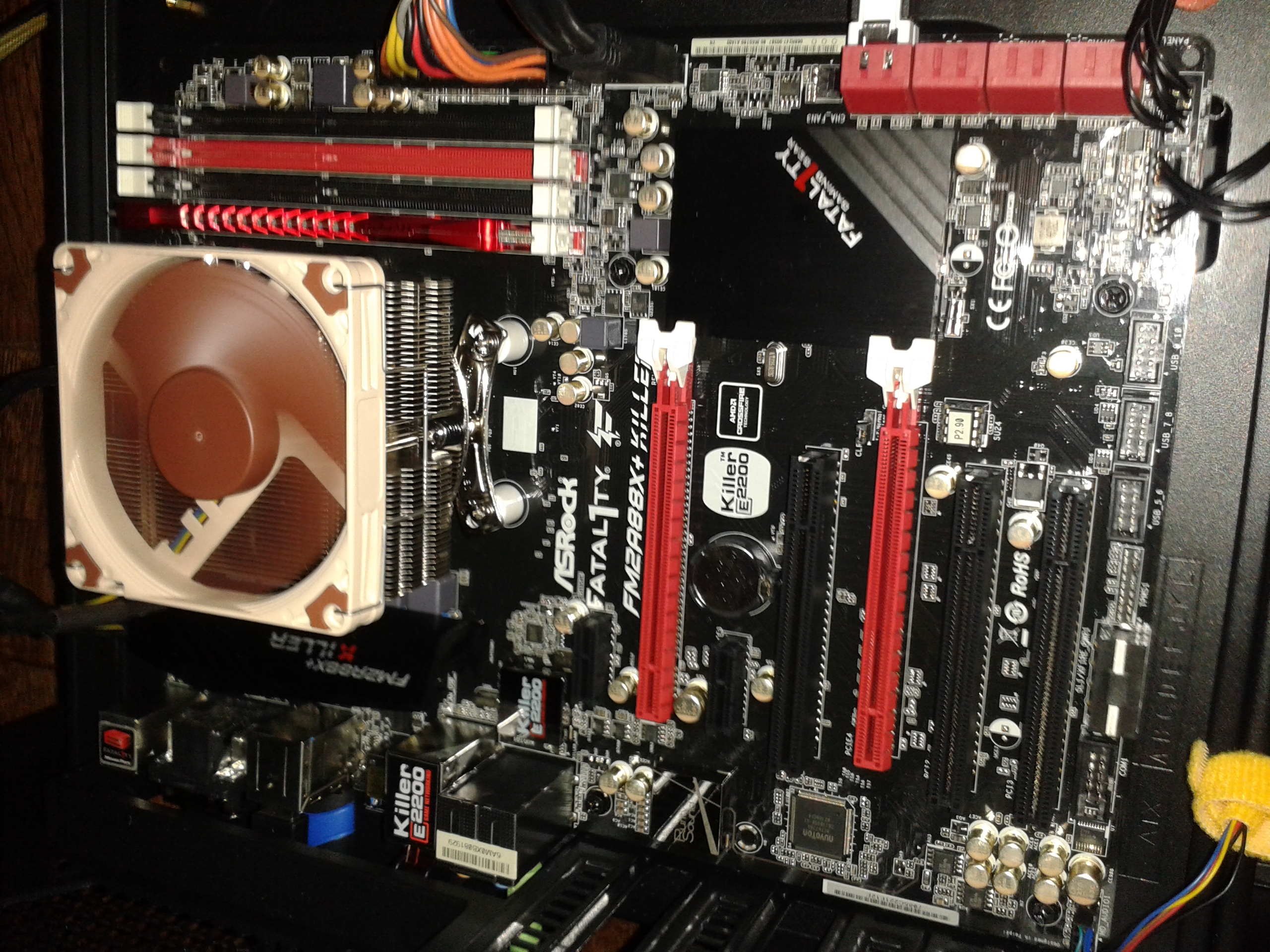

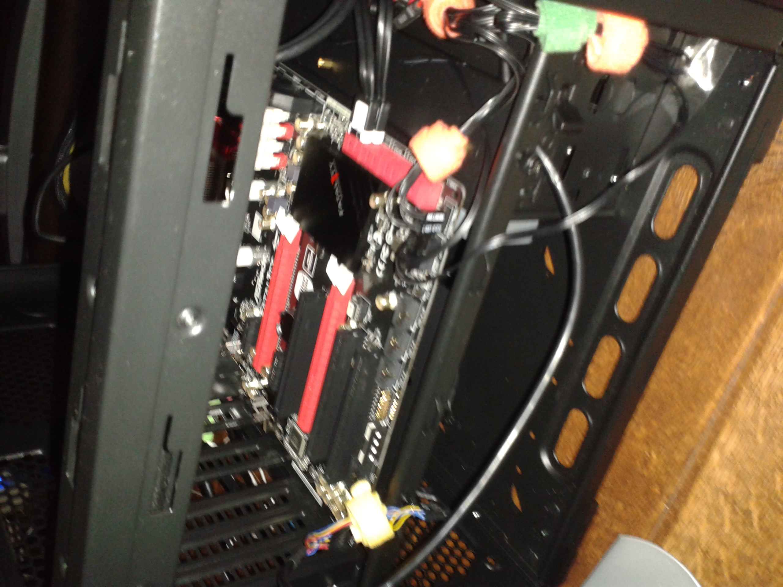

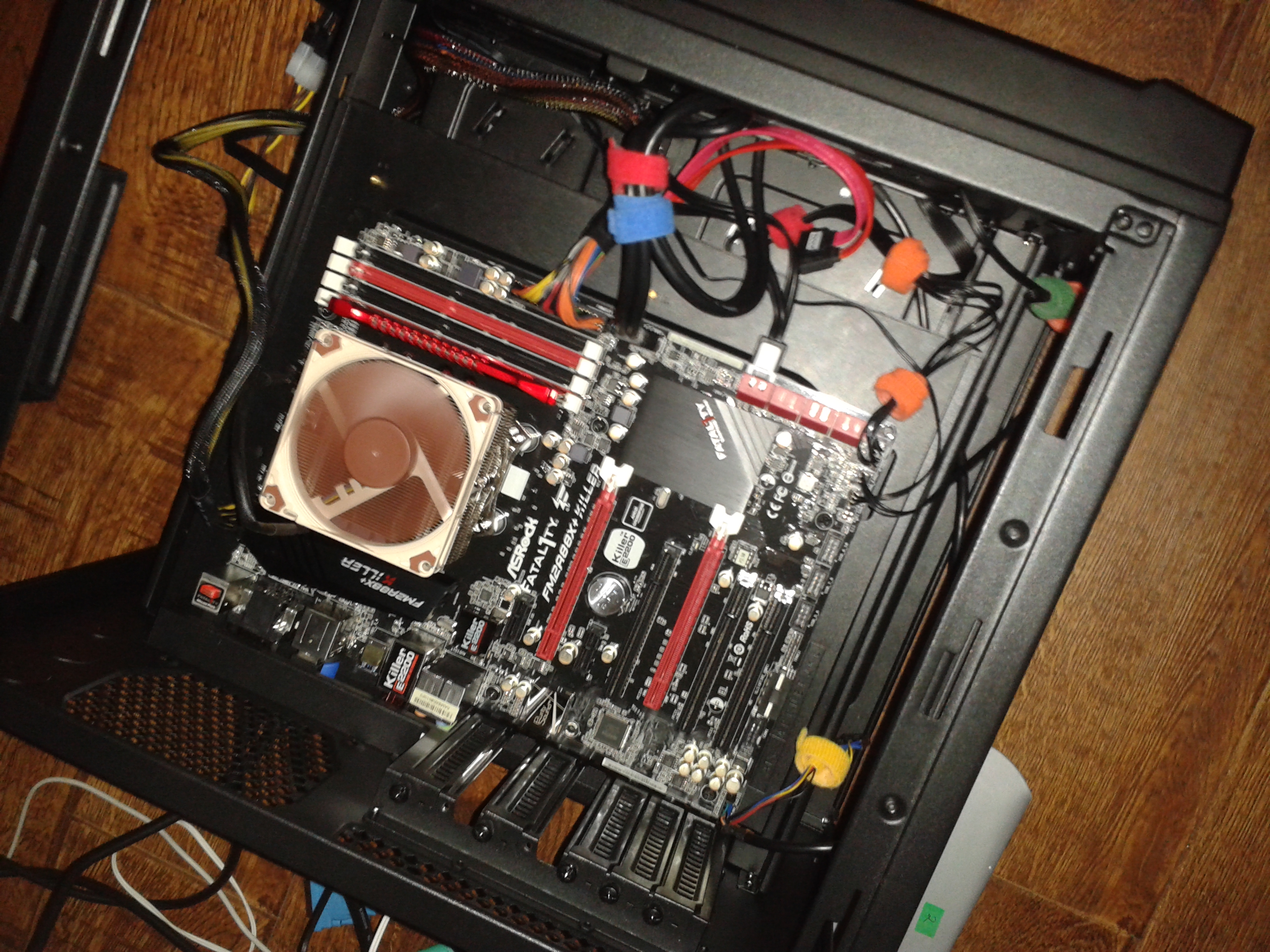

Just 3 pics of said computer case / test bench - very handy - this is getting quite a bit of use --

The one in the picture is AMD FM2+ - Dante was aking how many cores were in the Z170 / H170 build for the 7700 K - With so many CPU's it's difficult to just know how many cores there are.
The picture is FM2+ AMD - 7870 K APU (graphics AMD Radeon R7 included) - AMD varaiant of HD Intel ! - It's a 4 core CPU
https://www.cpubenchmark.net/cpu.php?cp ... 0K&id=2531
So not that powerful - like an i3 really - but how good it is for real time audio - only time will tell - but AMD isn't as good as Intel from reports of other users.
Yes it is a nice build that why I bought it for the Scope PCI cards that have been collected
