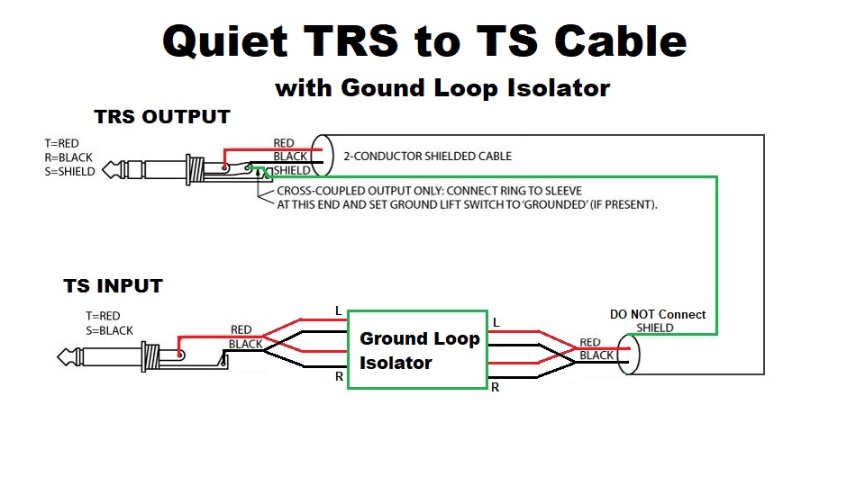

This is what the Hum Eliminator is doing internally

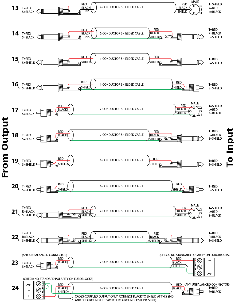

Here's a good article that covers this in more depth than I can muster right now. I'll attach the relevant image here and reference that it's probably #14 that interests you, but I do suggest reading the article too if you have time.

don't usually need a transformer in the first pic...

I used setup 14, but the cable was 1-conductor shielded. ( so black and green in pic 14 was identical)
When using 15, all is quiet again.
